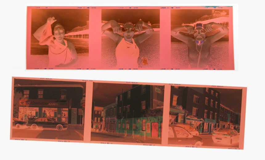

As already has been suggested, if the OP can provide a picture like this, it could help solve the problem.
