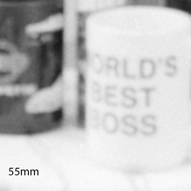

I recently picked up a C220, and I really like it, but I seem to be having focusing issues. I have three lenses (55mm, 80mm, and 180mm). None of them are perfect; the 55mm has internal spotting (not a haze), the 80mm has the beginnings of separation in the rear group along the edge, and the 180mm has haze on a number of elements in the both lenses. I use the 55mm and 80mm, but haven't used the 180mm for anything other then a focus test.
The 55mm is what got my attention with a focus issue, with this photo:
attachment.php
It looks to be front focusing quite badly. The fort is what I focused on, but the grass in the foreground is the only thing that comes close to being in focus.

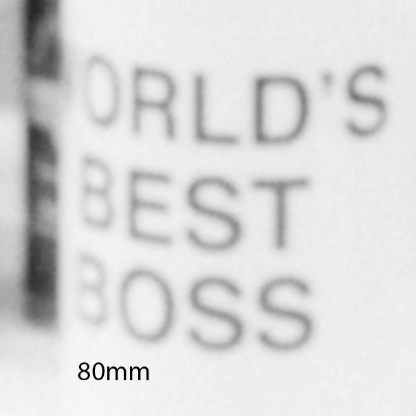

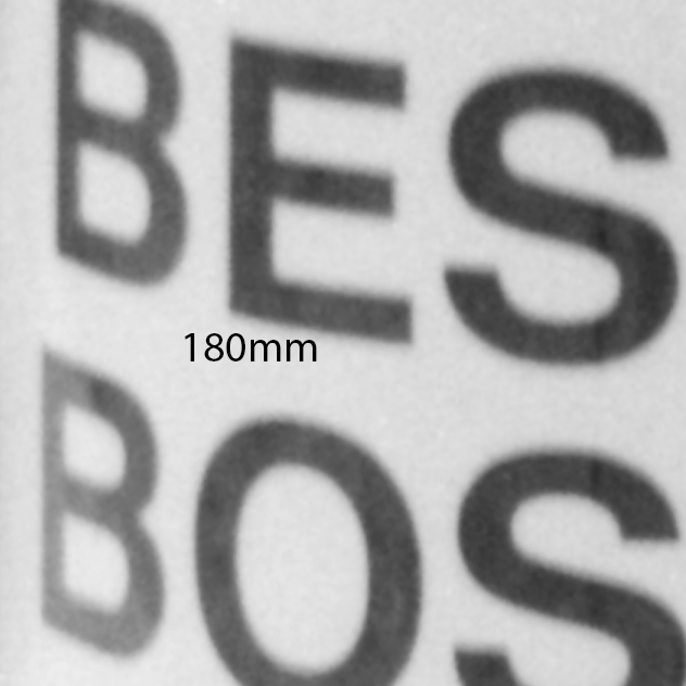

I decided to do a focus test with all 3 lenses to figure out if it was the lens, camera, or me. Took 3 shots with each at different distances; 30ft, 10ft, 5ft in the backyard just as a quick and dirty test.
These are from the 5 foot test, cropped to 100%, all were focused on the "World's Greatest Boss" mug. (Ironically, the 180mm lens which has the worst haze (and a potentially flipped element), gave me the best center focus.)

I use the magnifier always, and I even used a loupe to confirm my focus on the GG.
None of the lenses wobble when mounted.
The focus issue is there with both 120 and 220 film (the fort is on 220, the mug on 120).

With the 180mm pretty much spot on with the focus, my only other thought is that both the 55mm and the 80mm aren't shimmed properly internally, or something. But how likely would that me?

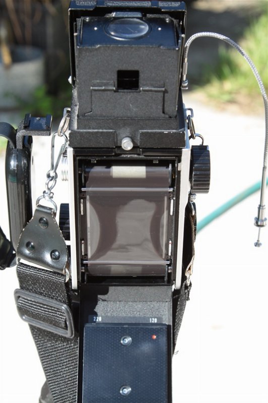

Well, using a loupe on the GG and at the film plane, the focus on all three lenses match. Hmm, are my eyes getting that bad? If it is my eyes, why would it look in focus to me, but not on the film? I would think I'd only be able to guess at best focus if it were my eyes.
I'm going to have my daughter do the focusing on another test roll. She just had an eye exam 2 weeks ago, and she's 20/20.
The only other possibility that I can think of now is the pressure plate, but wouldn't focus have been bad on the pics from the 180mm? I have 3 shots from the 180mm, and they all look better then the others.
As a ground glass for the film plane, I couldn't use wax paper, as it didn't stay flat across the plane no matter how hard I tried. I decided not to take apart other ground glass units, and instead made myself a focusing aid out of film. I had some developed rolls that had long leaders or unexposed frames, and I attached that to two spools, and made this:
attachment.php
Worked really well I must say.

So using a ground glass from my 124G, focus is off. When I focus on the film plane, I have to move the bellows out a touch to get the ground glass in the WLF to be in focus, and vice verse.
So, do I add or remove shim(s). There are two shims presently installed. And can I use paper as the shim, or what would you recommend?
EDIT: and this most recent focus test was done according to the C220 repair manual - 80mm standard lens, wide open, camera 30" from target (focus calibration chart printed at 13x19") on tripod with cable release in bulb mode, focused using an 8x loupe on both GG's.

I went from removing all the shims, and have been adding them in one by one. Tedious. I'm using a combination of regular paper and photo paper. <shrug> I'm having fun making little paper washers for the rear.

A few shims, and many hours of checking, and....... it's fixed to where I find it acceptable. I can focus on the 10lpmm in the wlf, and get just about there on the GG at the film plane. MUCH better then it was.
