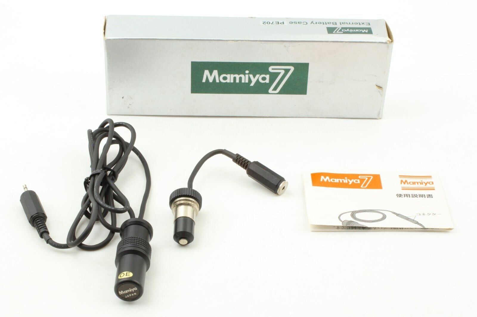

Not sure if this would work, but Mamiya did make an external battery case. I have one, and use it when I'm outside during the winter (when temps are well, well below freezing). The below external case allows the battery to be worn inside a jacket, with your body heat keeping it warm.
How cold is it outside? Does it work inside?
