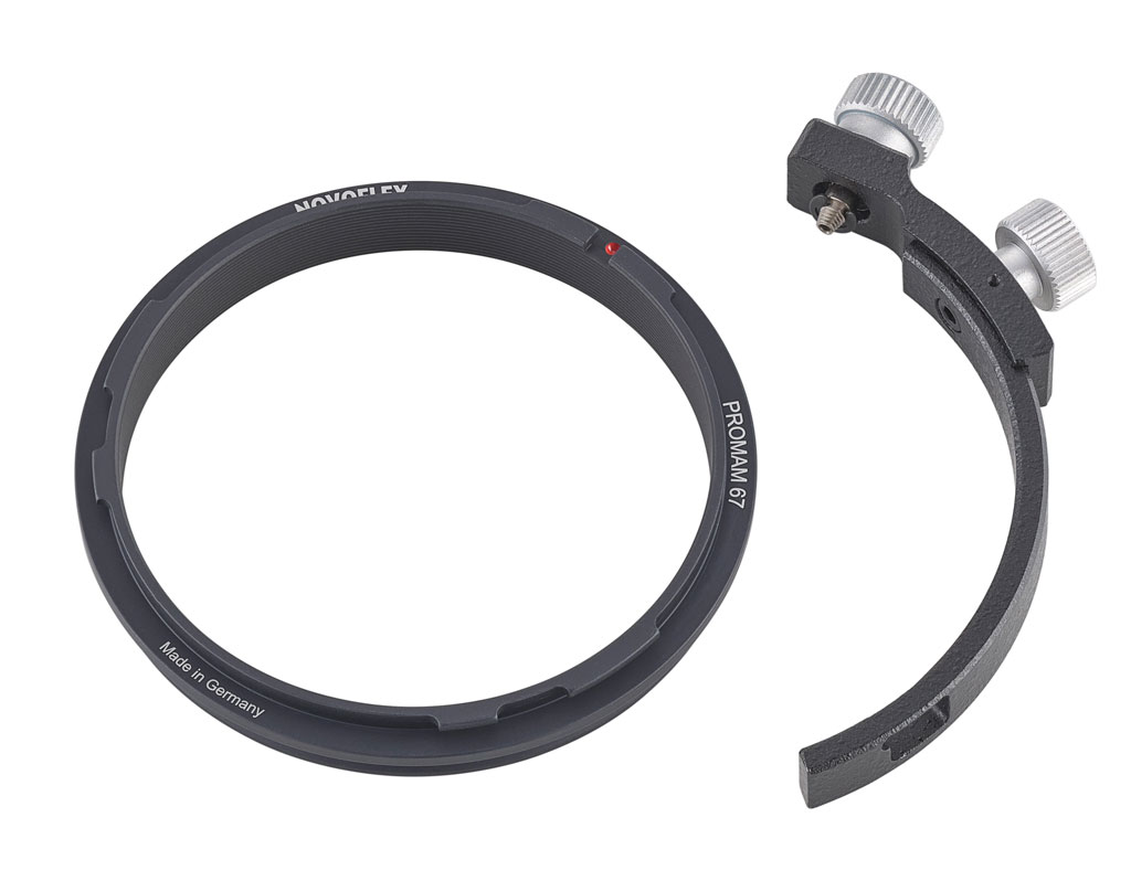

I want to ask, is there a way to set constand aperture closed down(say to f 11) on Mamiya 140mm F-LA macro lens? I want to use it on lensboard, so i want to set it to desired aperture. the aperture preview level on side of batter closes it only when i push it down, but i found no way to close it for permanent.

Thank you for the link. So without that device, as i understand, it's not possible to close down aperture constantly, right?
About the sound, it's the sound where the floating element comes out and inside, so i thought it's normal behavior of lens. I attach a video, just to demonstrate that this element probably does the sound.
Exactly. The DoF preview lever bracket is the solution for that.

Thanks Mike. I want to ask, is there and alternative to what Alexander6x6 said about how to close down apertrure constantly? on my other lenses of mamiya 127mm and 180mm , i can close down(via 2 ways) and the aperture stays closed down to the wanted one. On this lens, seems like there is not such option, right?
I just wanted to use it on lensplate for cambo actus so i need it to be constantly closed to desired aperture.
To my knowledge there is no alternative. Even Novoflex is including this bracket into its Mamiya 67 set.

Yes, i have the SOFT version, it does have lock for aperture. Never tried 180mm regular. on my 127mm i have another trick to close the aperture on rear mount.
So, what about 140mm, no way to do that without specific tool?
I'm only aware of using the depth of field preview for stopping down before firing the shutter, but it's not something i've explored.
Mike
The purpose of this lock on the 180 SOFT is to enable the lens to be focused (i.e. at f/8). Otherwise, this is not possible.
You've already asked this question. I've never done it myself, but you could try using duct tape.
