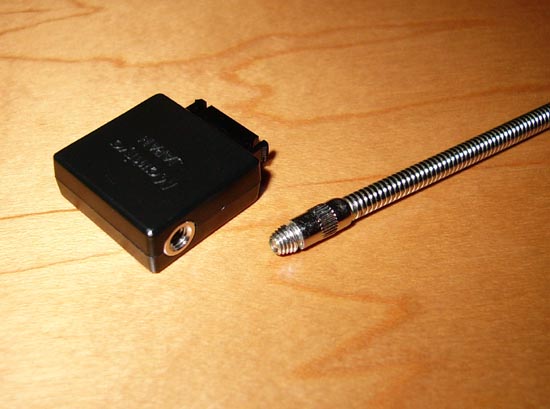

It came with a cable release adapter but I am not sure it works or if I am using it right? I slide open the side compartment, plug in the adapter, screw my cable release into the adapter, but using it will not fire the shutter. Camera is on, wound, everything seems right. What am I missing? thanks!

Ok, here is a pic of the adapter, and I was just trying to use an old cable release with it..

see the section that has the ridges ringing the bottom fo the cable release? try unscrewing that. Only reason i say this is, I did it once myself and someone pointed it out to me. I felt like a total idiot.

mine doesn't unscrew, but it has the locking mechanism at the top. Wehen I push down on the top the bit does extend out of the bottom about 3/4 of an inch. hmm

That's what it is supposed to do. If the cable release is working it must be something in the adapter. My 645 which is an original one, just had the nice little hole/port what ever you call it to directly attach the cable release.

lol, I found what it was. I did not realise that the shutter will not fire with the darkslide in. Took the darkslide out and it was fine, hehe
