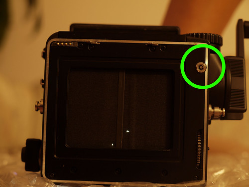

Also, there is a pin on the back of the body, top right corner next to the shutter.
http://youtu.be/D2W301xUBSY In this video (skip to 3:43) the pin pops out and then quickly retracts after each exposure. But with my camera, the pin does not retract half of the time. Should I be worried about this? Could this be related to the frame rate problem?

This is the pin that I'm talking about. Ignore the holes in the shutter, just something else to be fixed :tongue:
