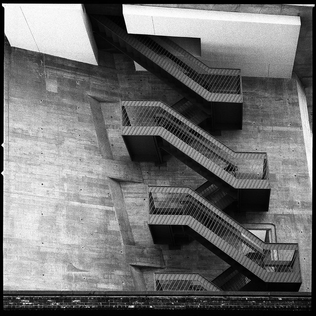

Set it to 1600 and develop for 1600, or set it for 1600 and -1 exp. compensation if the camera doesn't go up to 3200. Develop for the times given for 6400...or more.
I shoot at 6400 and develop Delta 3200 for 24-27 minutes in full strength D76.
I get good contrast range and nice tones with this method.

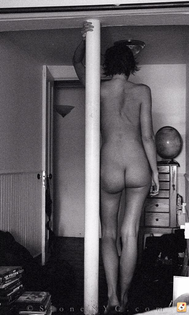

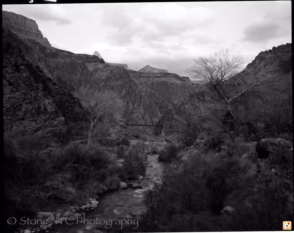

Also some examples shot at 3200 in DD-X
And 120
The 35mm was shot in a very dark house, the 120 was shot using a red filter, the first two daytime, the third, dusk for 2 minutes exposure and yellow filter.
Just remember to use gentile agitation/inversion for best grain.
