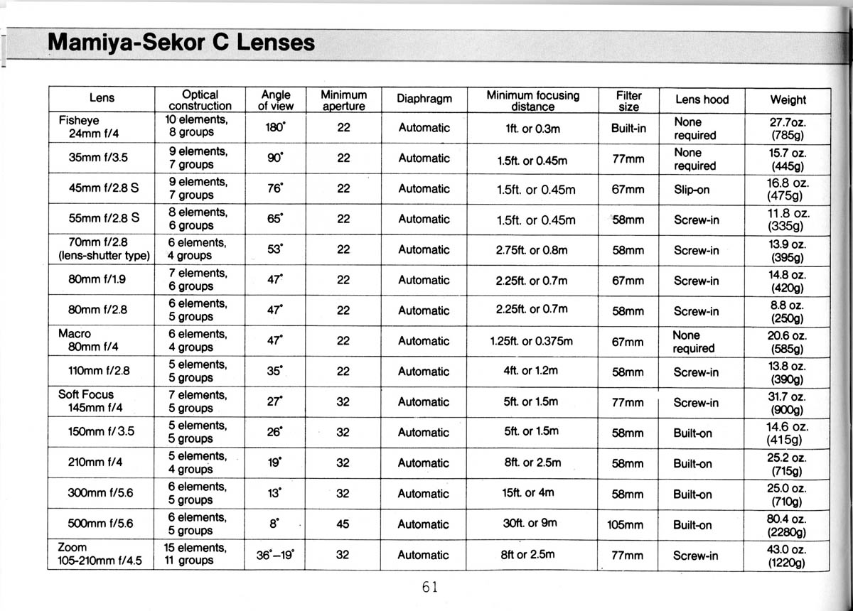

Going through old manuals and thought that some people might find this lens chart from about 1981 may be informative.
Found a chart from 1984 with some changes such as the 45mm S lens. and added it to the post

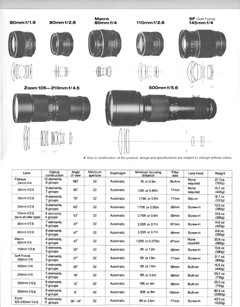

Thanks for this martyryan. It inspired me to look through a bunch of my stuff, and I managed to find a brochure from (I think) 2005 that shows the updated chart, including the "N" lenses.
I've attached it as a pdf.
It would be great if the moderators could change the title of this thread to something like: "Mamiya 645 lens charts from 1981, 1984 and 2005"
  • Mamiya 645 lenses-2005-chart only.pdf
And here are the photos of the lenses themselves and element diagrams, from the same brochure:
  • Mamiya 645 lenses-2005-lens photos-1.pdf
  • Mamiya 645 lenses-2005-lens photos-2.pdf
