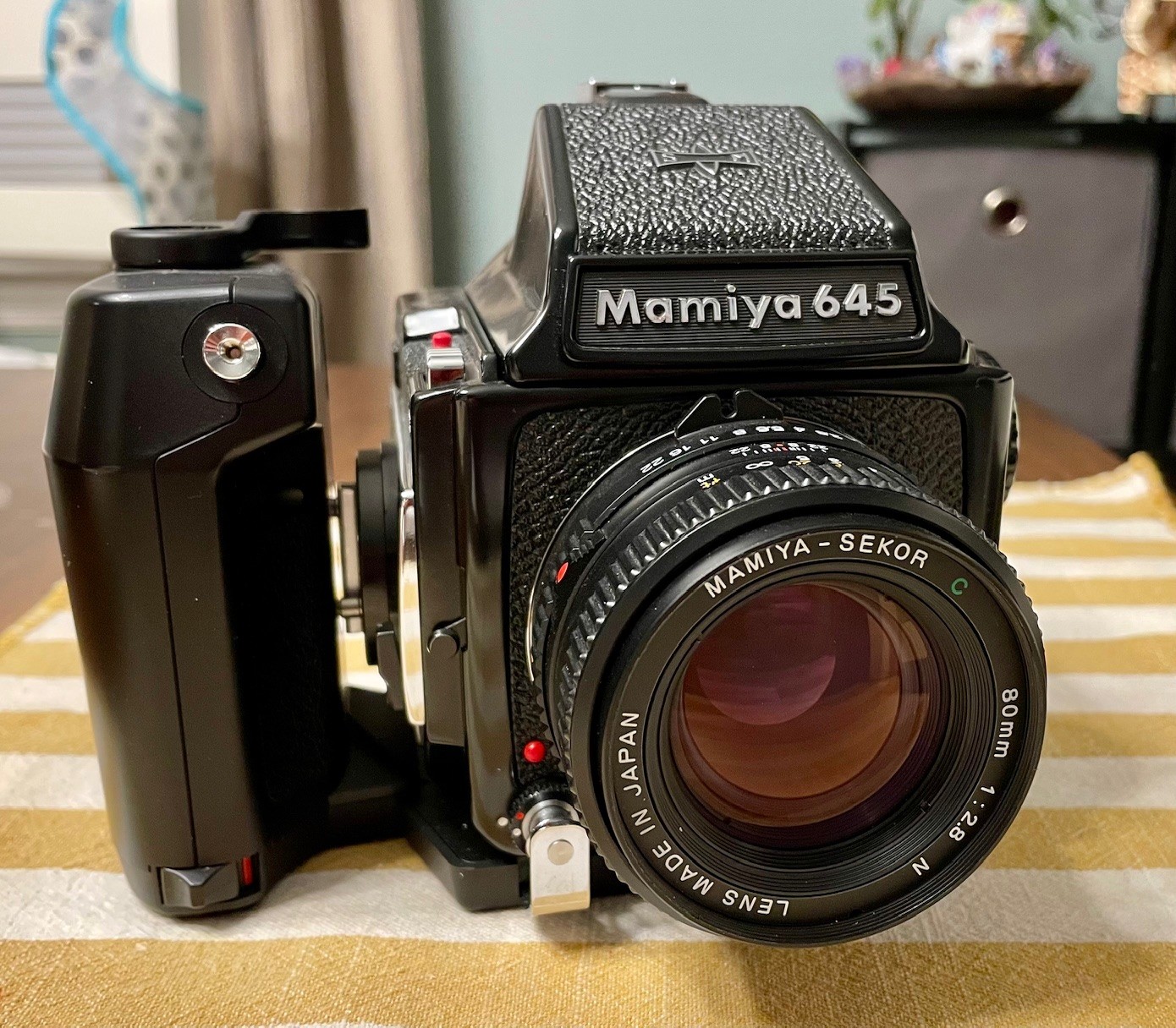

On my Mamiya 645 1000s I use the right handed manual winder made for the Mamiya 645E. Works great. I’m not sure many people realize this winder works on the older 645s (before the super). I’m assuming it would work on the regular 645 too?

On my Mamiya 645 1000s I use the right handed manual winder made for the Mamiya 645E. Works great. I’m not sure many people realize this winder works on the older 645s (before the super). I’m assuming it would work on the regular 645 too?View attachment 393209

The 645e winder grip works on all the early m645 cameras- I had one on a m645j. The other kinda cool option is the pistol grip which works really well with the m645 and is nicely balanced with that camera.
