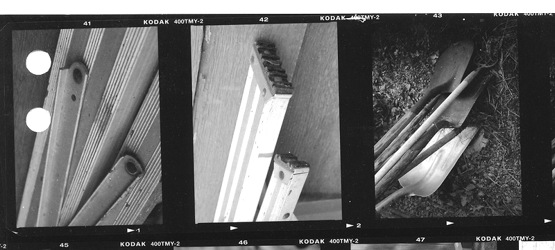

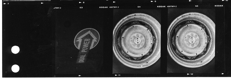

Here are two excerpts from a scan of a contact sheet which show a bit about how the frames and the edge numbering of Kodak film line up for me when I use my Mamiya 645 Pro.
I refer to the alternative edge numbering - 41 through 55 - because that coincides with the framing on 6x4.5 cameras.
Near the beginning of the film, showing frame number 41 through 43:
And the last three frames on the roll, showing frame number 53 through 55:
You will note that those frame numbers are adjacent to almost the exact centre of each frame.
The white holes are where the sheet was punched for the binder the contact proof is stored in (incorrectly on the first try).
In the OP's case, his/her film is advanced about 1/2 frame width less before the first frame is exposed.
