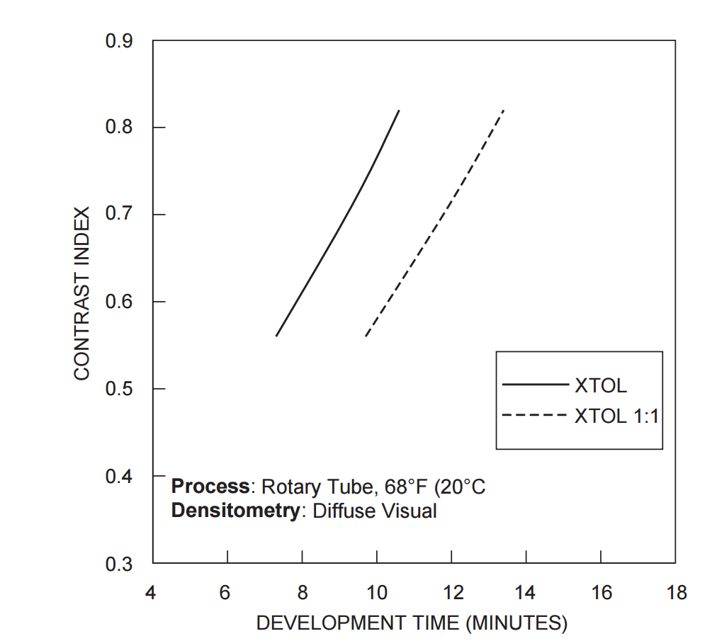

If you have Xtol only then table says 1+2 dilution 17.5 min. I would do it semi-stand for around 20min in tray. Xtol has a mild speed increase of about 1/3 of stop, not bad. Instead Rodinal would tend to decrease effective speed, compared to Xtol.
It seems 2 stops under exposed ? Why not just look to see what Xtol says to do for film under exposed 2 stops ? Usually it is between 30 and 50% additional development / stop ... if it was me I’d ditch the Xtol and dinafine and get some plain old id11 or d76 and use that I always have had problems with Xtol ( super thin contrastless negatives)... or I’d get some DEKTOL and develop your film for 8.5 mins 1:6 .. an never go wrong with sheet film in dektol or ansco130 ... its better to have a negative with meat on the bone than very little there.

Look up the Kodak XTOL data sheet on how much extra development time is needed. Added development time will increase the density and contrast for under exposed film.
