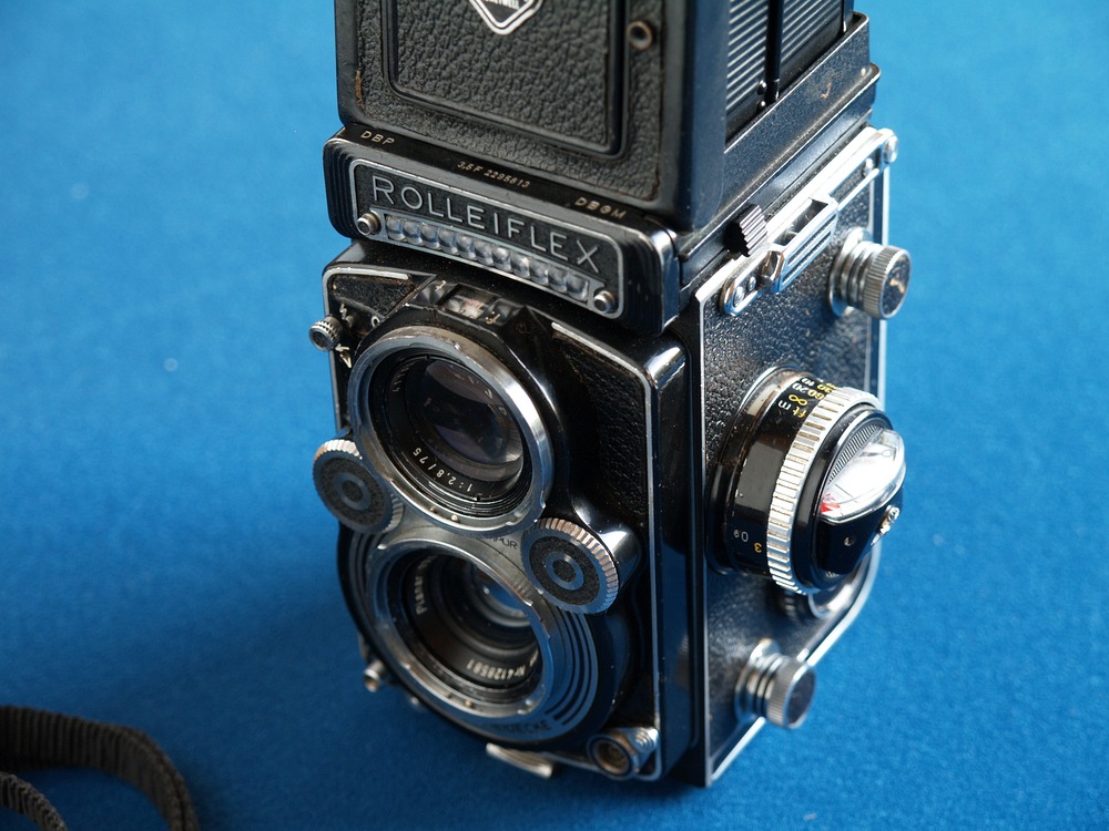

Thanks for everyone's input, it has been a long journey but finally have a 3.5E1. Bought a CLA'ed (by Pro Camera in Charlottesville) 3.5F from a reputable dealer, shutter/aperture wheels would barely turn, light meter not working, sent it back for more CLA, told it was "broken beyond repair" (??) and so I was left with some Rollei accessories and no Rollei.
Thankfully I now have the 3.5E Planar CLA'ed by Harry Fleanor with a Maxwell screen for the same cost, which is a huge plus in my book
If anyone could be so kind as to answer a couple of novice questions, it would be much appreciated.
-I've read the manual, and I still don't understand the high/low EV scale and how that translates to setting my exposure. I match the needle, and then I know I want a EV of 9 let's say, and so I will just have to know what shutter speed/aperture combo is equivalent and set it to that? I know it's slower than a handheld meter, but I'd still like to understand it.
-Bought a third party hood that looks machined well, but I can't get it to lock and don't want to force it. The seller said "it should be tight on first use" but I don't want to mess up the mount. How likely is that to happen?
Excited to get shooting! Thanks all.

From a user standpoint, the other main difference (besides removable hood) is that the meter on the F is a single range coupled version. The E metered version has an uncoupled meter from which you read the EV value and transfer to the aperture and shutter setting. The meter has a high and low sensitivity range. I will also note that many of the Es came without the meter. IMO the latter are preferable, as any good hand-held meter will be better for general use than the older selenium meters, many of which have cells that no longer give reliable results.
I had both a 3.5E and 3.5F with selenium meters, and, amazing, they worked well and were linear when I sold both cameras about 2010 (stupid decision, of course). I hope the current owners are enjoying their Rolleiflexes! I replaced one of them with a 3.5E without meter, which is fine as I use a hand-held meter. Once upon a time, Rollei sold Gossen retrofit meter kits for the E bodies, but they disappeared decades ago. Rollei also sold replacement plastic meter covers for both E and F focus knobs (also unobtanium).
3.5F with dual scale focus knob and working light meter. 5-element Planar lens. The one I should have never sold....
