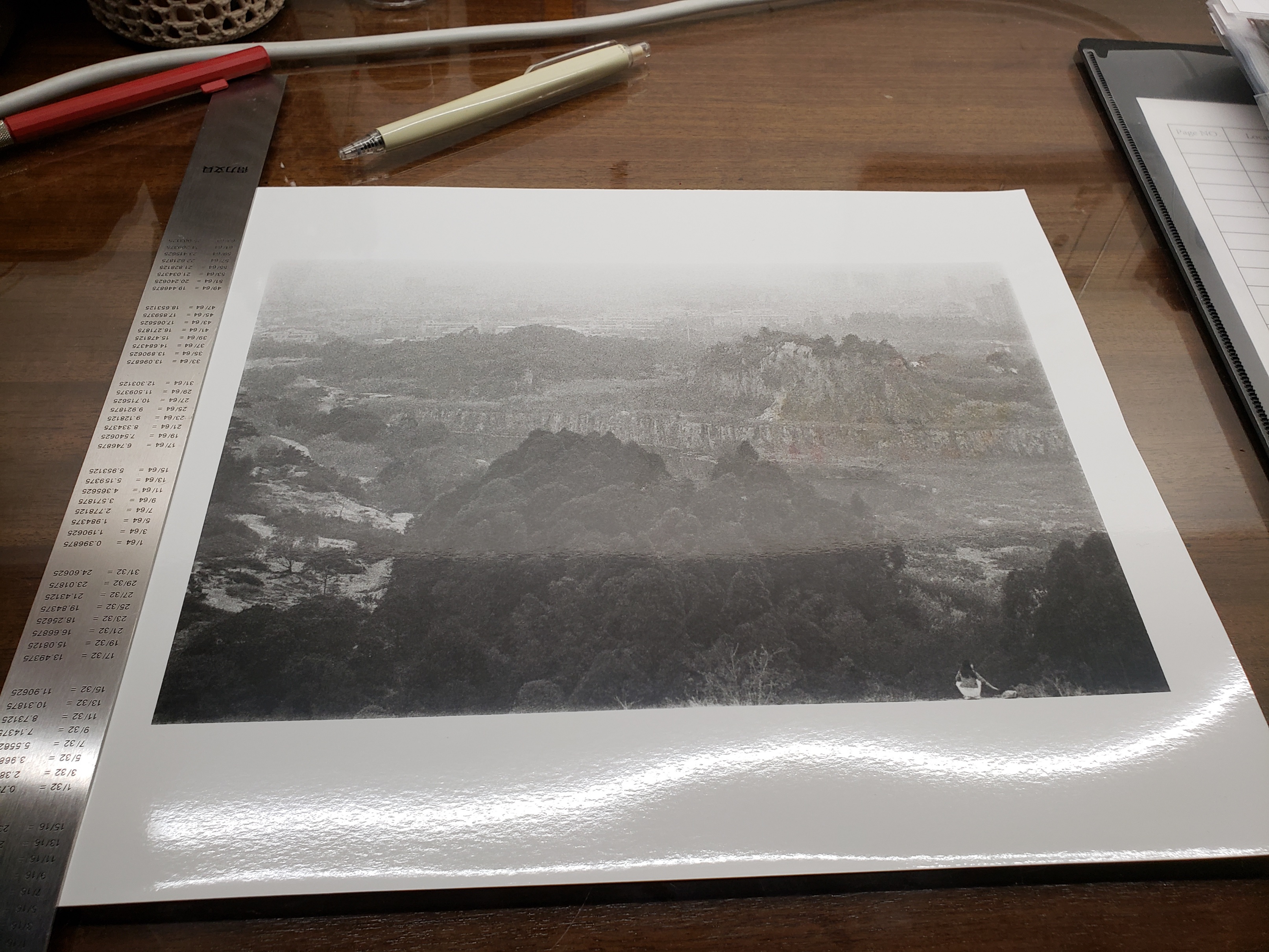

The first example shot with Canon 500mm prime and Pancro 400. Enlarged on a 12*10 paper, #5 filter. Image is 10inch wide. Another example is Foma 200, #1.5 filter,same size.

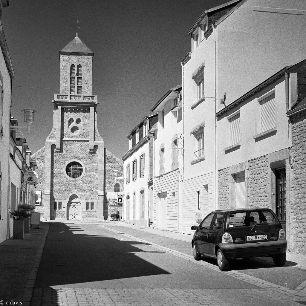

Bretagne: small village - church by Chrisdavisphoto, on Flickr

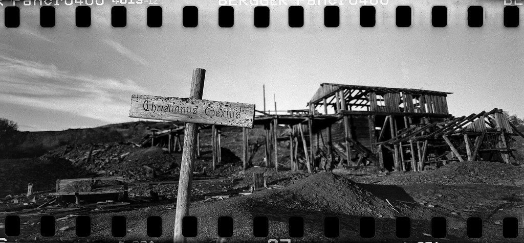

Christianus Sextus with Bergger Pancro by Jonny Kristiansen, on Flickr
Looks pretty sharp to me. Are you sure the problem is not your technique?

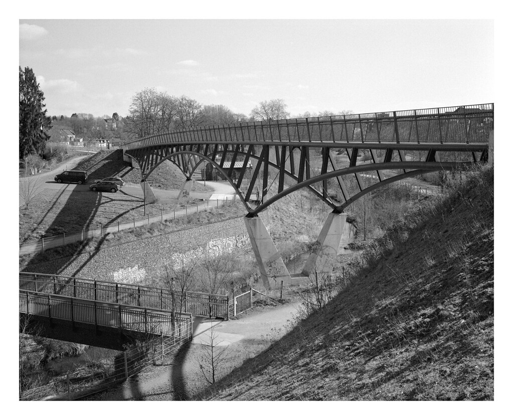

Flexaret VI, Bergger Pancro 400
Adox XT-3, 1+0, 12 Min.
Silver Gelatine Print
