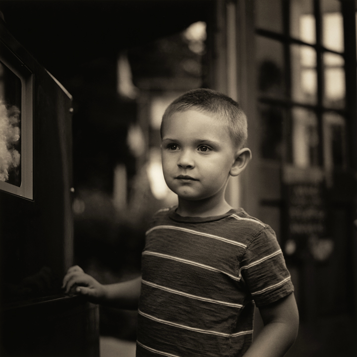

15,708
Switzerland
I have some 6x6 young portraits of niece and nephew, exposed on pushed tri-x and pulled delta 3200, developed in d76 1+2. Really nice highlights and midtones on the face. I'd to extend the highlights out slightly for the glow, but keep sharp shadow detail. So no overly diffused light.
From push processed Tri-X to pull processed Delta 3200 you will have two completely different negatives to work with, which will require completely different treatment to achieve similar results.
Your Tri-X negatives are likely to require a lower grade paper/filter than the D3200 ones in order to give similar overall contrast, assuming you care about consistency.
To make either of them sparkle will mean you have to focus on different areas:
Tri-X - pushed will have a lot of contrast. I would say you'd need to spend a lot of time on mid-tones, to make sure you have enough detail in the skin tones to pull the viewer in. You may have to work with selective bleaching to adjust local areas of detail, as your highlights are likely to need printing down, and your shadows are likely to require dodging, and a face has both highlights and shadows.
D3200 - it's already a low contrast film to begin, and if you pull process it will be even lower. You're likely to have to work with very high contrast filters to render satisfying contrast in the print. I like shooting D3200 @ 3200 and process in Ilford DD-X according to their time for 6400. That gives me the best negatives for normal contrast printing.
For both types of prints I'd try using an indirect toner such as sepia or thiourea, using a very weak bleach diluted so you only bleach the brightest highlights and tone them back. This gives the highlights a beautiful glow and sparkle. If you subsequently tone with selenium, you darken shadows, and your highlight toning will intensify. This changes the color of the print to warm on all papers, but it also gives a really great black with nice sparkle to the highlights.
Here's an example on Ilford MGIV developed in replenished Ethol LPD, toned in Moersch MT-3 and Harman Selenium. Negative was FP4+, exposed at EI 80, processed in Xtol 1+2, medium contrast negative.
