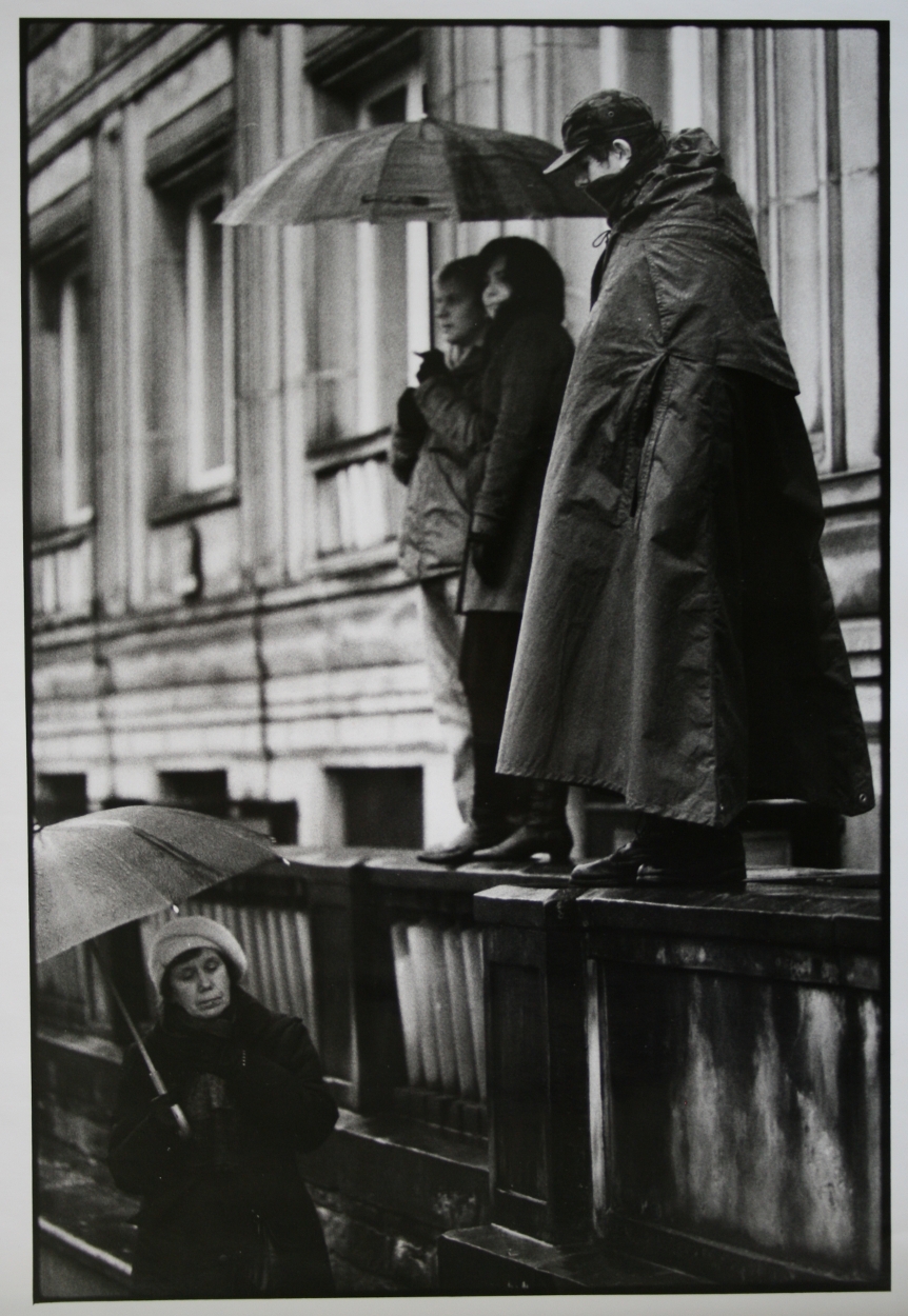

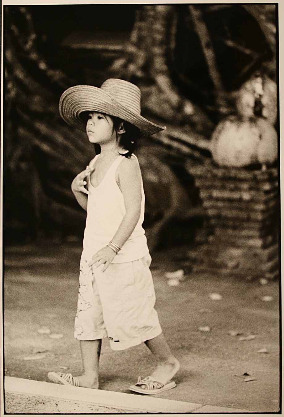

So,
This question has little digital - but in presentation purpose.
I would like to make online presentation of my prints, but they are 30x40 cm big, so scanning is not an option. I am thinking about taking the photo with a digital camera (standard canon dSLR small sensor with kit lens).
I will use enlarging mask to keep the print flat and in place, and put in on the chair.
I was thinking to use natural lightning - on the balcony in cloudy day.
Questions: which kind of settings I should use for the lightning, distance from the print (1, 2, 3 meters), f stop, angle of print (print should be vertical and take the shot in same level, or print on 45 degrees and take a shot from above) ... ?
If somebody had done this with success - any comment is welcome.
Thanks.

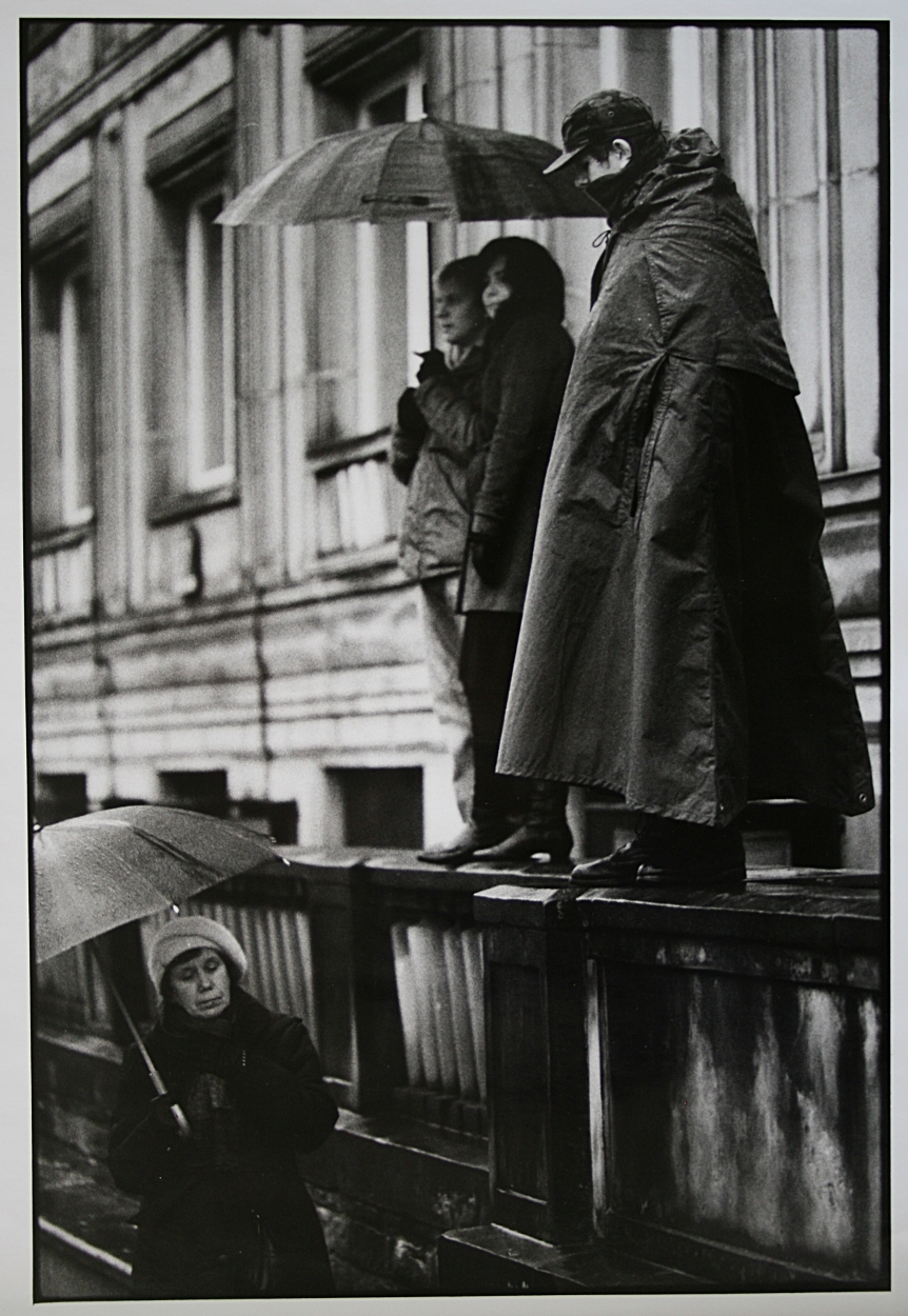

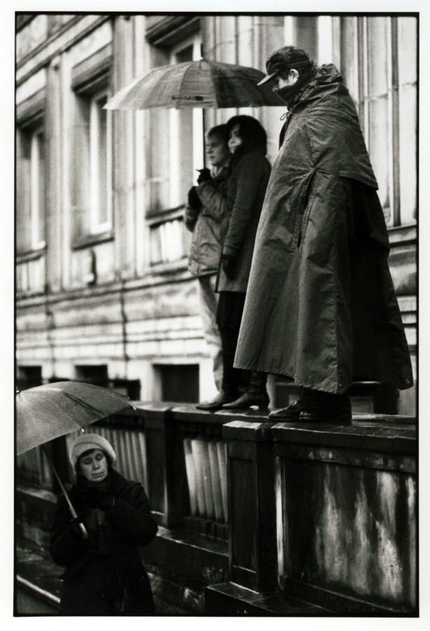

Here are the first results: no lightning used beside big window (natural light).
Attached are 3 files:
I will try with lightning on 45 degrees from both sides on the weekend.

If you have a transmitted light facility on your scanner, why not scan the negatives and reverse them in Photoshop?
Too much post processing work with scanner, and still not so nice as photo of a print, print has nice warm color that I can not so easy get in photoshop editing. I don't want to spend hours and hours in photoshop editing. Also scanner can not get the whole negative size (and little more to get the black edges - scanner mask always cut some part of negative, around 5% ... but we are going in OT area :smile: ).
