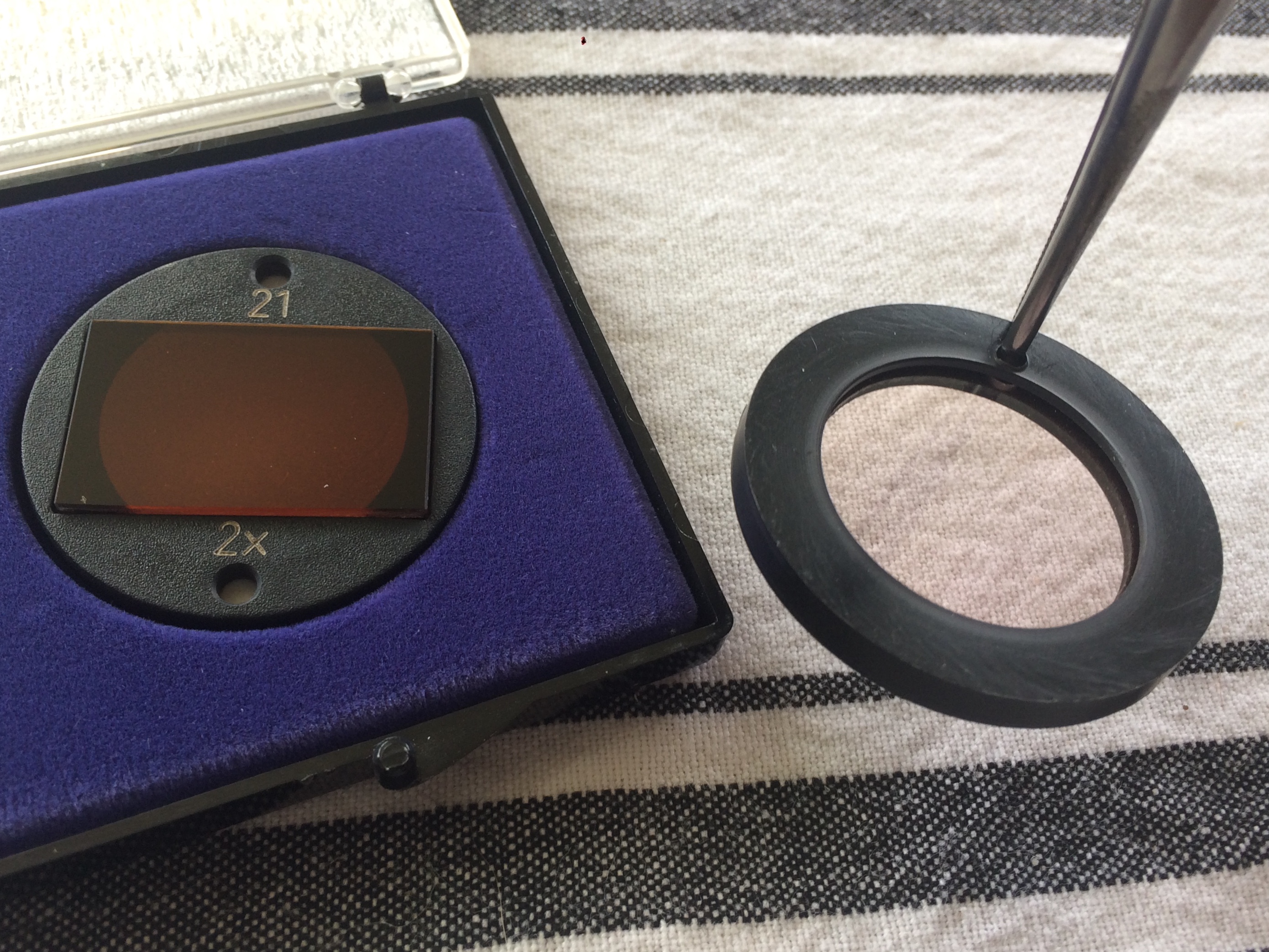

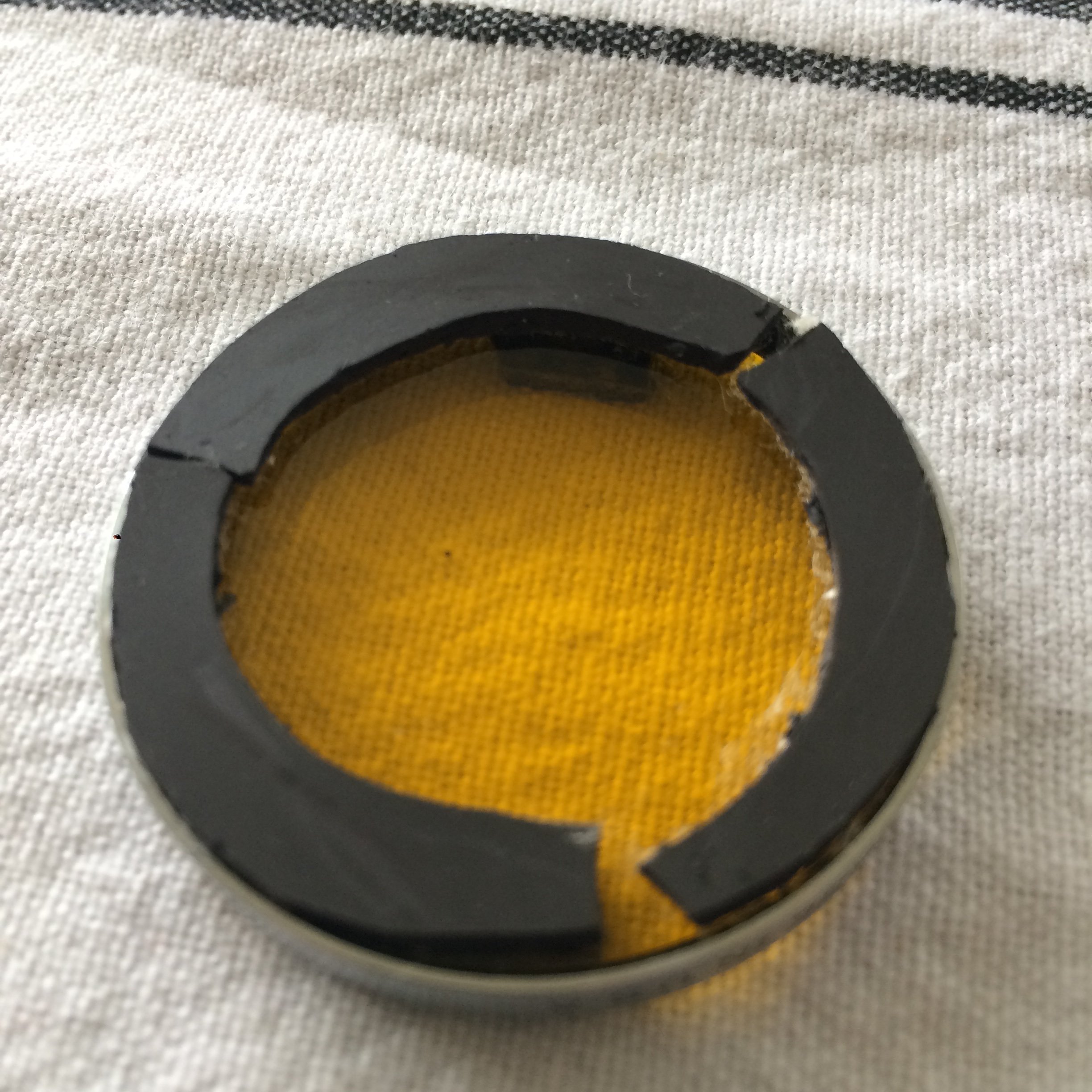

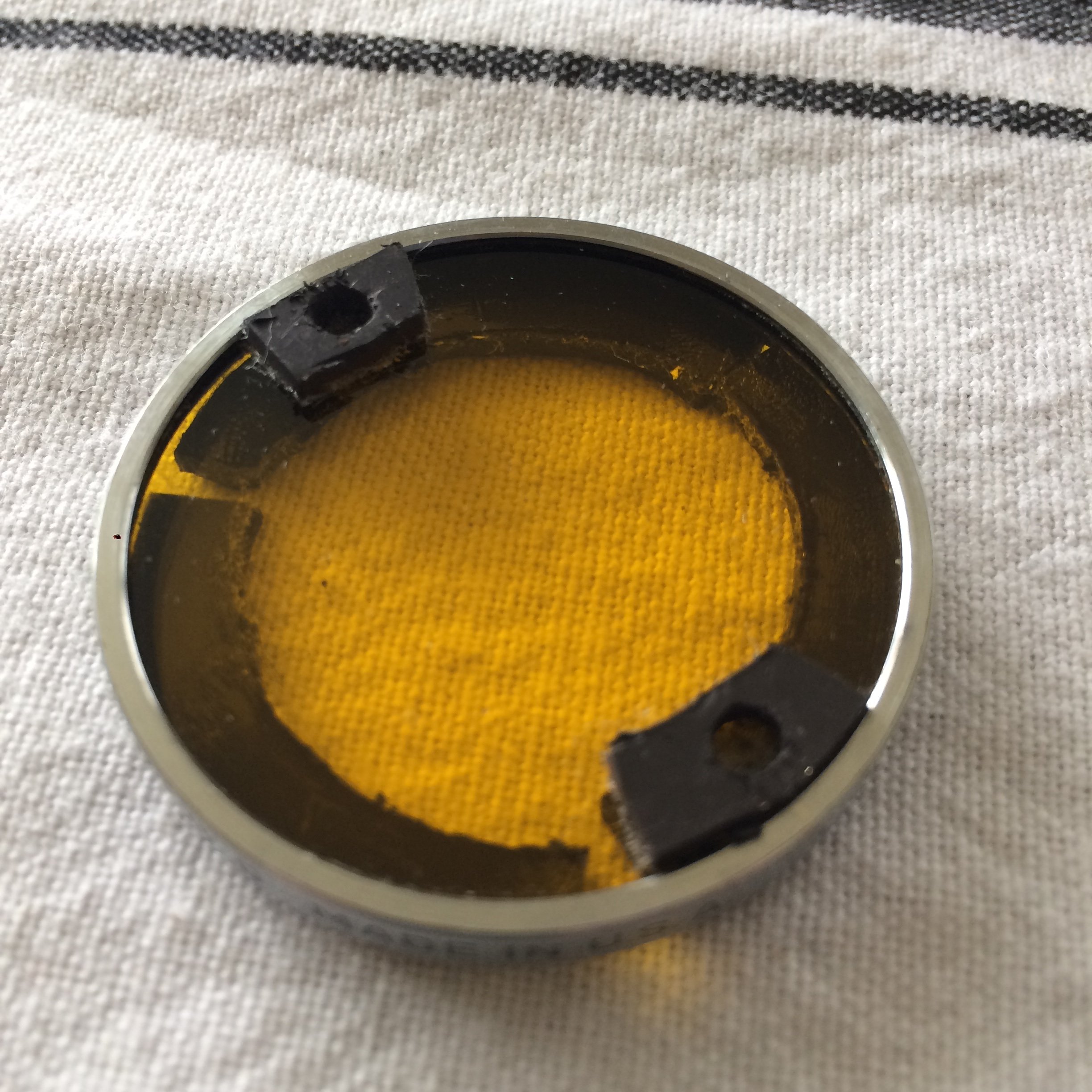

73B4B0E7-99C5-4AD5-B189-F092A82530A0.jpeg 2D77248D-55FD-4F6A-A2E0-2F0BF25D7173.jpeg I have access to series IV (6) filters that are the perfect diameter to modify for Noblex 6/150 camera use. I cut flexible refrigerator magnet material in curved strips and used double sided cellophane tape to attach. (Maybe super glue would work too) Then I also used the same refrigerator magnet material for 2 little pieces with 1/8” hole punch to be able to grab, hold, with 6” long tweezers. Mine could be prettier but for now it’s very functional. When I have time I’ll probably redo it with more skill.

I originally got my 6 inch long tweezers from a hospital where I was working as their photographer. I missed placed my tweezers and in the past few days located 6 inch long industrial tweezers at Grainger supply the brand is general. 6 inch long tweezers at Grainger hardware supply the brand is “General”

So the small hole on one side of the filter allows you to hold a filter with tweezers to place it over the lens.
