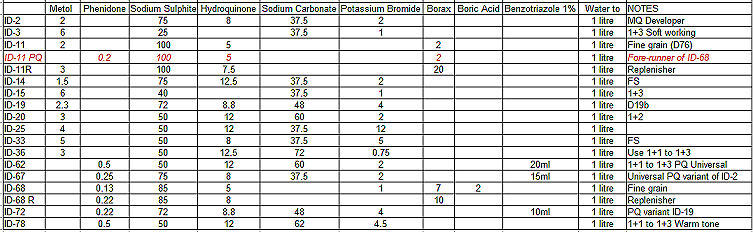

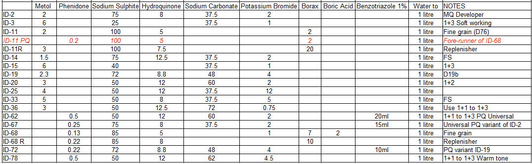

OK Nick, here's the comparison chart as promised, its only a few of the total published.
Ilford Developers Higher resolution
You will see the main developer types:
ID-2 MQ ID 67 PQ Universal film & paper developers
ID-3 M only Soft working developer for films or papers
ID-20 MQ ID-62 PQ Film & Paper developer (fine grain if used quite dilute).
ID-11 MQ ID-68 PQ (Microphen) Fine grain film developers
ID-19 MQ ID-72 PQ Clean working Industrial, Aerial photography, x-ray developer.
ID-14 Contrast developer, for films and papers.
Of course Ilford have published many other formulae, using other developing agent etc but these give you something to start with, all companies produced a similar range of developers. The commercial version of D19 is more likely to be closer to the D19b variant.
The comparison between ID-19 and ID-14 is interesting - I'll try some A/B comparisons between the two (once I have compared D19 and D19b)
Maybe the ID-72PQ as I already have phenidone here and can scratch ordering the metol
Again though, just out of interest> what does 'Clean working Industrial' mean in terms of subjective qualities in the final print ? I know I have plenty of examples here as its what I have been using, but I am not very good at reading differences in developed negs with nothing 'standard' to compare them with (like the same neg in D76 for instance)
Thanks for the chart, its a pretty good starting point ! It really shows there are some pretty standard chemicals when it comes to the Metol/Hydroquinone developers - I'll try to find out what each of the components do, like Sodium Sulphite is there in every one, it must do something vital ...
