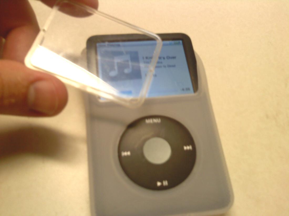

Hello! I searched for a relevant thread but didn't come across anything, so my apologies if this has been discussed.
I'm going to be working in a public darkroom and I'd really like to play music in there since I recently picked up some really nice headphones (Ultimate Ears Triple.fi 10Pro IEM's to be specific :D)
The Ipod screen is rather bright with light that's not-so-safe. I'd rather not run outside or hide in a corner every time i want to pick a song.
As you can see in the picture (sorry about the quality! It's from a camera phone,) the case I have has a piece of plastic that protects the screen. My first thought was to just slide a piece of colored translucent plastic under that part, but I'm not sure exactly what color I need (just any ol' red or amber?) I thought of using a safelight filter, but all the ones I've seen are too thick.
Any ideas? How about other novel approaches? Thanks!

Eugene Smith put a red filter over a B&W TV in his darkroom. I'd try a few layers of red lighting gel equivalent to a 25A filter, and be sure to test (especially with multigrade papers, which are more safelight sensitive than graded papers in general) before taking it into a public darkroom where others are working.

I'll be sure to test it, David. Is it adequate to just eyeball a gel that looks close to a 25A? I'm not sure how exact the color needs to be, or how exact safelight color is in the first place.

Might consider getting an old iPod Mini....it has a monochrome LCD. That is what I use. Otherwise, the red filter (e.g. rubylith) idea should work well. Red Saran wrap would probably work if you put enough on.

My thought is that a good deep red filter will cut enough transmission, besides color spectrum, to eliminate most any problems so long as you keep it oriented away and 4-6 feet distance. Test of course.
Rosco conveniently uses the standard numbers for their gels that match Wratten filter colors, so look up "Rosco #25 gel" on the B&H website, or your favorite supplier, and you'll find the right color.

Thanks for all the replies! I'll probably try out the red filter method and see how that works. A local photo shop has a large amount of new old stock screw mount filters. I may try removing the glass from the mount on a 25A filter and using that. They're selling them for $2 each. Step down/up rings are $1 :D

I use a sheet of 027 Medium Red lighting filter from Lee Filters over a laptop screen - I've not seen an Ipod screen, but if it's any brighter than a laptop, try a couple of pieces.

Go in the iPod settings and set the backlight timer to 2 seconds. When messing with it, just point it away from the other people.

find some rubylith at an art store.

I think a little patch of rubylith, perhaps in multiple layers, would probably do the trick. Cheap as dirt, sticks, and is designed for the purpose.

As suggested, get rubylith at an art supply store, that is exactly what I did with my ipod (and an old tv too, retired now due to DTV conversion) one layer is enough, very easy to read and works well outside the darkroom too. I remember an old process darkroom (just lith film) that had a window covered with rubylith film, that window was the safelight most of the time. Kind of neat.
