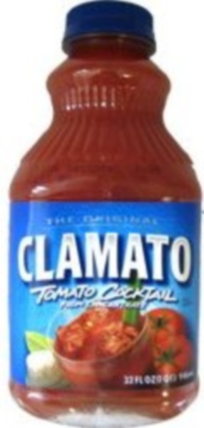

If you are going to re-purpose bottles, look for bottles that are fairly hefty - some are a lot thinner than others.
I like Clamato juice bottles:
They are made from heavier plastic, they have a larger opening and cap, they are more stable when standing and they provide a good grip - really handy. The 64 oz size have an even better handle, a better cap, and if you buy the different flavours, they can be colour coded.
It is not good to use food containers for non food items including photo chemicals. Mark all bottles clearly to avoid accidents.
MattKing
Apr 24, 2005
54,172
Delta, BC Canada
The Clamato Labels are also easy to remove. And of course, I've never met a kid who likes Clamato juice. :smile:
But Sirius' general warning is entirely appropriate - if you are going to re-purpose anything, make sure that there can be no confusion!

I like that. Would have to take that label off though, not sure I even want to think of something called Clamato juice. Down In Louisiana we would eat anything that wasn't quick enough to get off the plate, but this would be a hard sell.
