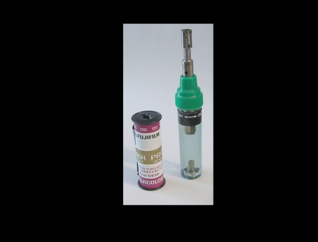

This is the BernzOMatic "Mini Torch". built like a Leica with a very efficient variable valve. fits in your pocket. If you choose to light it, excellent for soldering.
