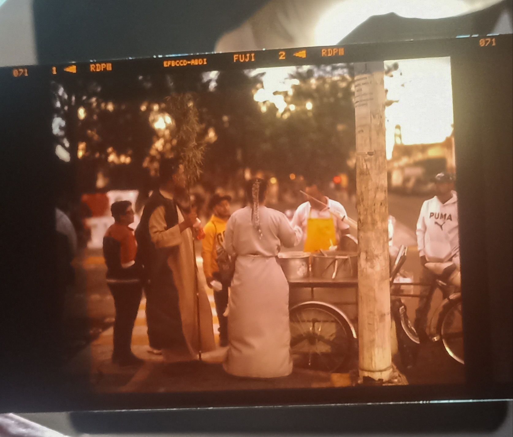

The film I developed was Fujichrome Provia 100F in 120 format, I made a mistake in the exposure in the camera and I shot it at ISO 200, so I applied a +1 push in the developer.

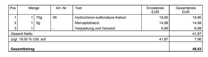

I would be interested too. This Mercaptotrizole chemical is €15 for 5g, but probably one gram will be unusable due to its volatility.

Not sure where you got this price quote from, I don't remember paying nearly as much for it. Also, Mercaptotriazole is not volatile IMHO, it's been sitting in its glass for ages ...

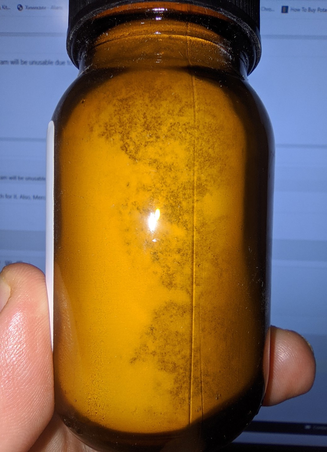

Well... this offer was made to me by Suvatlar - he was the only source I found. Maybe it's good to specify that the price is without VAT :smile:
Regarding the volatility - I haven't opened the bank, but I can see that the dust is stuck to the glass.
If you know of another source in Europe, I would be grateful if you could share it.
