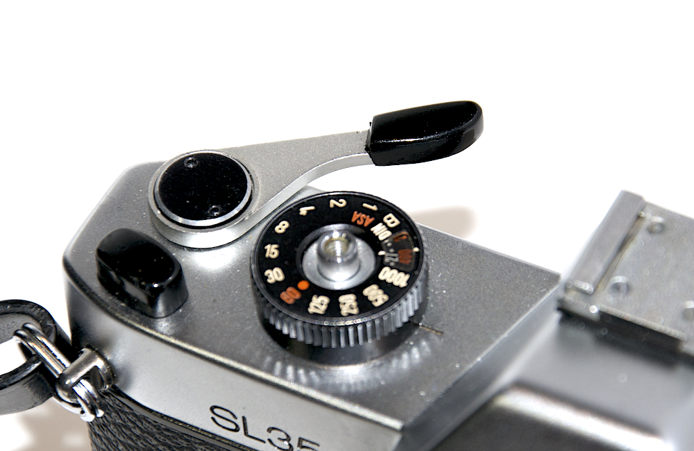

One of the Rollei SL35 cameras I bought to fix came to me without the little plastic tip on the end of the film advance lever. It seems these levers are hard to come by on the used camera parts market.

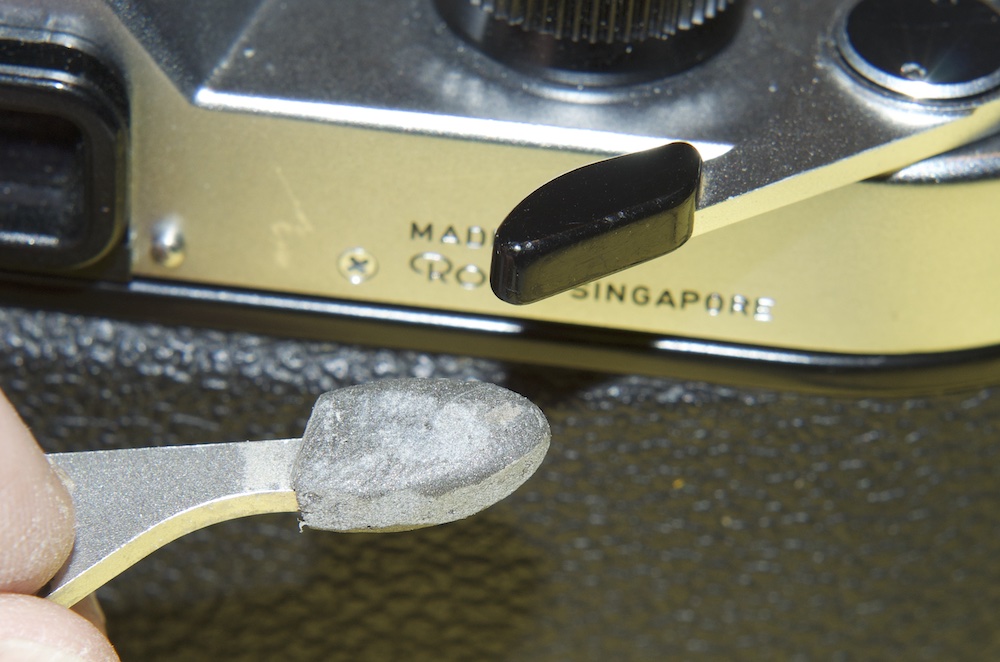

I put a blob of the epoxy putty on the end of the wind lever and formed it into rough shape as it set. I gave it a rough shape with knife, file and sand paper.

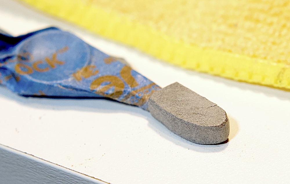

I continued using files and sand paper to get it to the correct size and shape:

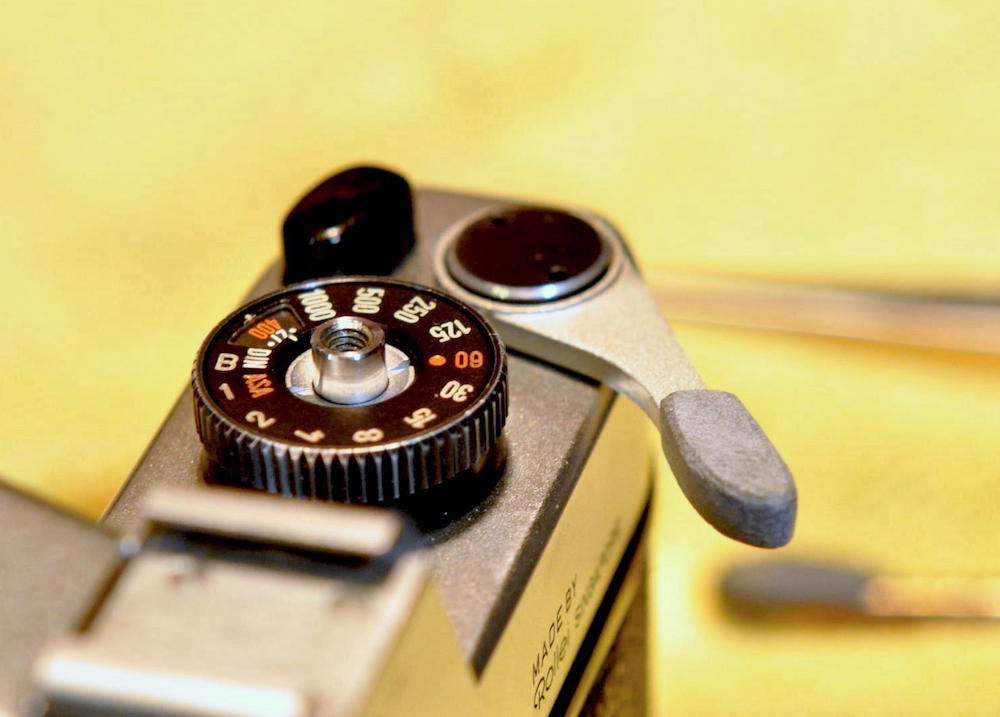

Before spending the time to put a proper finish on the part, I installed it on the camera and ran a few rolls of film through to make sure it would not fall off. Indeed the epoxy has affixed it to the lever very well. I also had mashed it into the two holes already in the lever, to help hold it in place.
