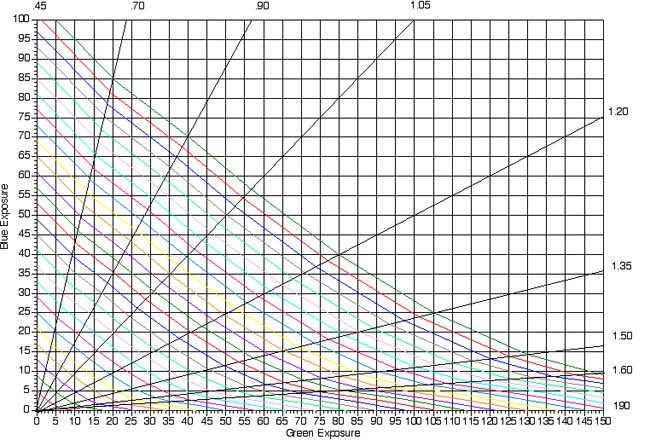

Are you varying the time or the percentage of filtration? In this tutorial the percentage of color is varied to make a numerical table that prints the same shade of gray at the same printing time.
When varying the printing time (with maximum color), I get a table like this which is something a little different, but works too.
Full Magenta and full yellow ===> split grade.
Split grade, Yes. So indeed one can make a similar table as shown in post #31 with magenta and yellow too. The colored lines (only colored to separate them) represent lines of a constant middle gray value at different contrasts. Similar to the multigrade table. The radial lines are ISO(R) contrast.
