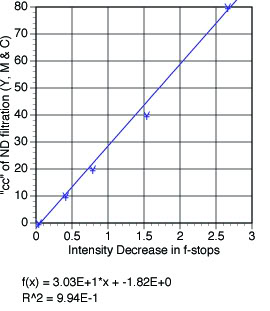

I got a bunch of Forte multigrade paper on sale at the local shop. Here is how I calibrated my color head to allow me to keep the same middle gray exposure while changing contrast grades with the color head. It involves adding in RED to the Magenta or Yellow filtration as neutral density, so each "Grade" has about the same exposure to print a middle gray. So, for example, 80cc of Yellow gives ISO R (contrast) of about 120. This will eventually become M 32 and Y 112 after the neutral density (32cc RED) is added, so that the printing time matches all the others.
This is not a complete tutorial (the complete version is here: http://www.butzi.net/articles/vcce.htm)
First I needed to find out how many CCs of neutral density on my color head equalled an exposure change of one stop. The Butzi article mentions using an enlarger exposure meter, but I used a standard exposure meter and it worked fine.
I plotted change in neutral density (CCs of combined Cyan, Yellow and Magenta) versus change in exposure meter reading.
ic-racer
ic-racer
Feb 25, 2007
16,693
USA
So the straight line through the points shows that one stop equals 30cc of neutral density with a 99% correlation.
Pretty cool, that means 30cc = 0.3 log = 1 stop :tongue:

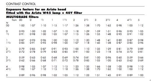

I once helped a fellow darkroom worker setup a Durst CLS1840 for split grade. Turns out the WHITE lever (that moves all the filters out of the light path at once) does not move the SUPPLEMENTAL filter, as it has its own lever. So we left the yellow filter in its normal place, full ON, and put the magenta filter in place of the supplemental filter.
That way he could easily go from max yellow to max magenta with the two levers.
Otherwise, with that head, it takes a bizillion turns of the hanging rods to go from 0CC to max 130CC. Your forearms would fall off after one print from all the twisting 😝
