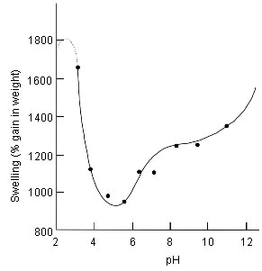

Gelatin swell profile
I had trouble finding this. Here is the swell profile as found at another site on the internet. More information is found in my lengthy post on hardening on Photo Net.
PE

The curve I posted above is typical of all of the bone gelatins that are in current photographic use. My work at Kodak included testing of gelatin swell as a function of hardening level using a swellometer. We were trying to find the optimum level of the new hardener. I have mentioned that also here and elsewhere.
