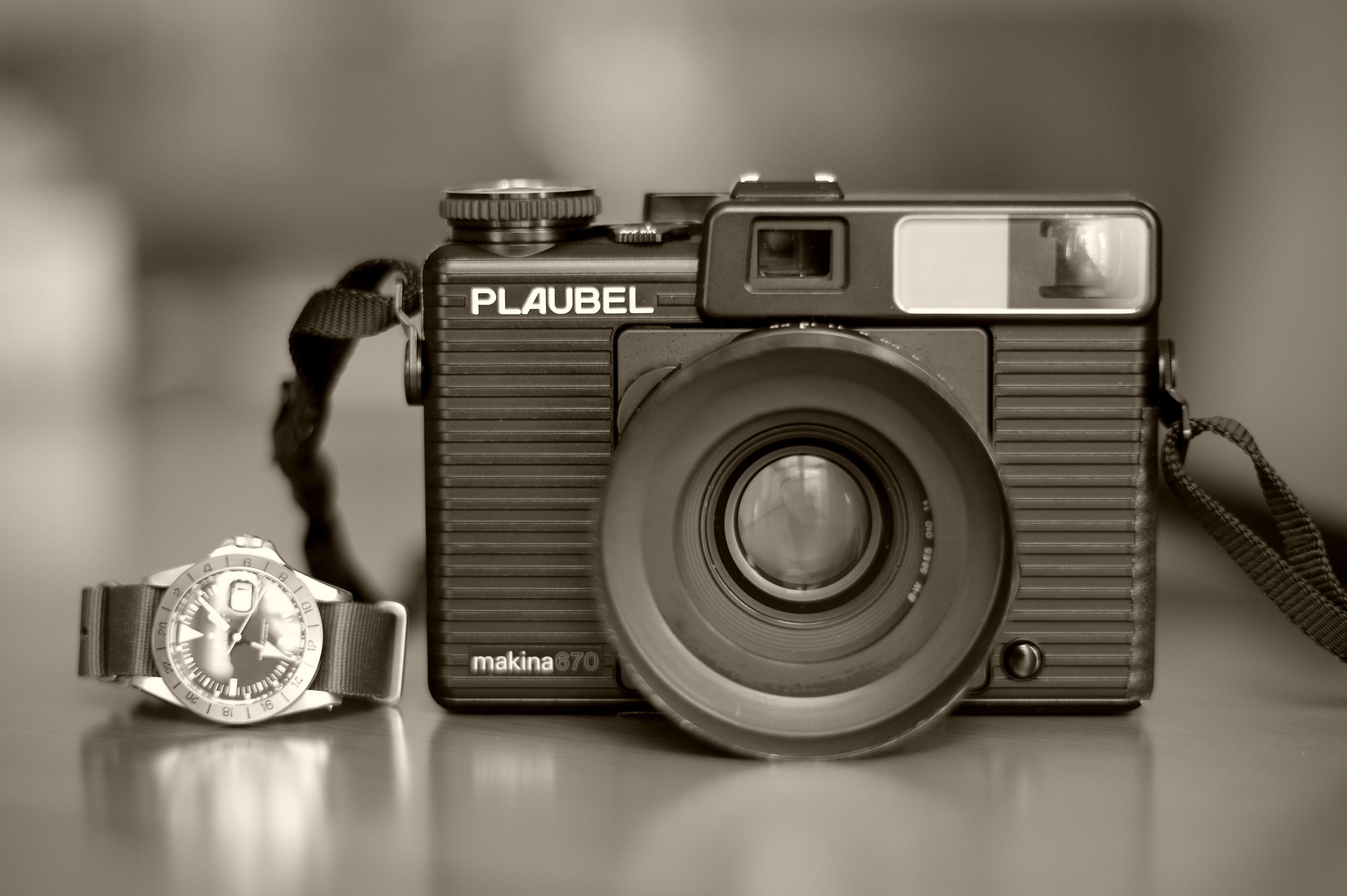

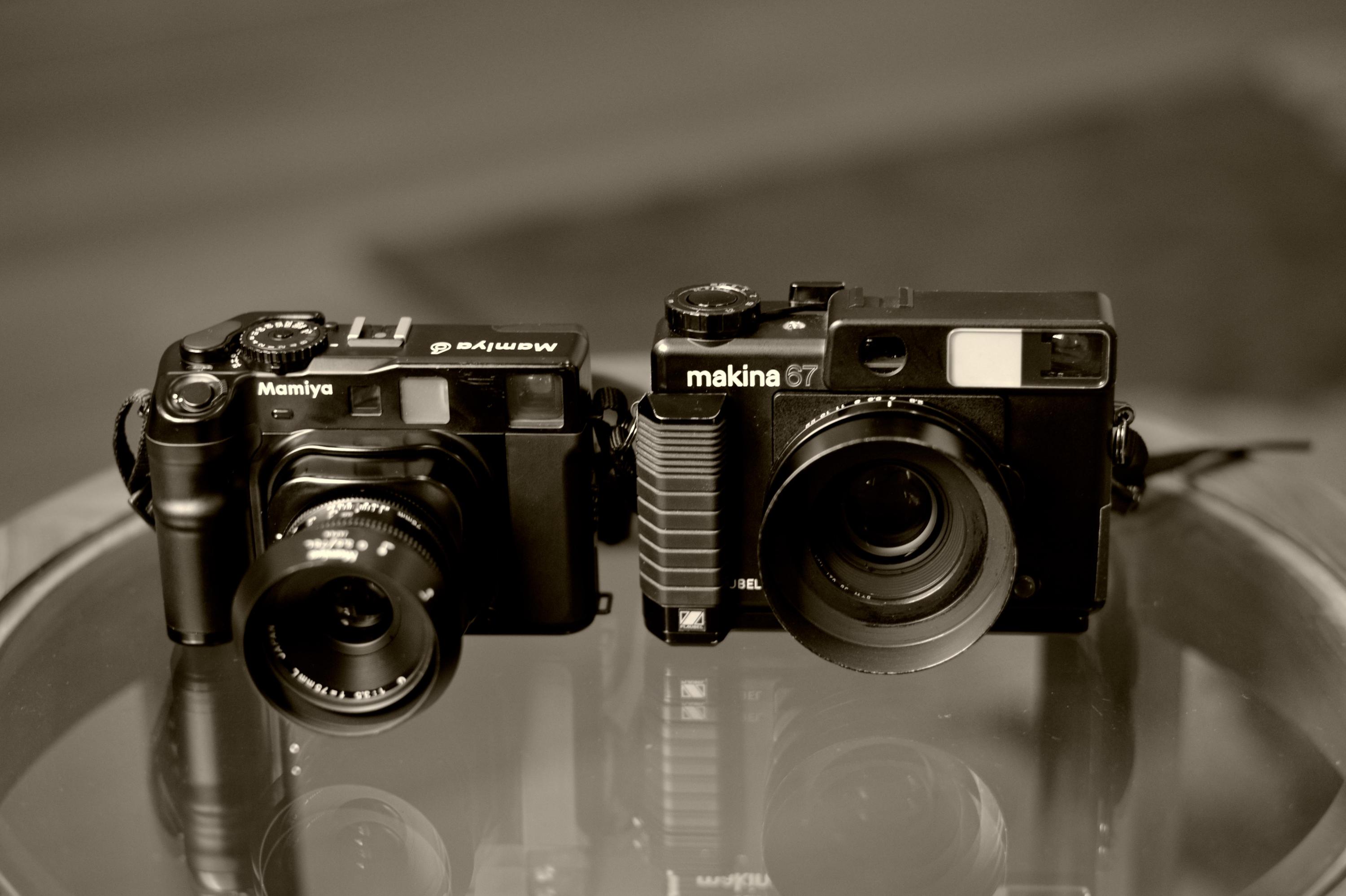

I found the makina 67 to have a better feel than the mamiya 6. The mamiya 6 I sent back to the seller after a few days of receiving it without shooting because there was a technical fault, but I already decided that I was not going to look for another mamiya 6 just based on the handling itself.
Feb 17, 2013
16
Singaporean
As for repairability, I haven't quite thought about it, except that I will try to shoot as many good pictures with these incredible cameras as possible until they break down. :smile:
