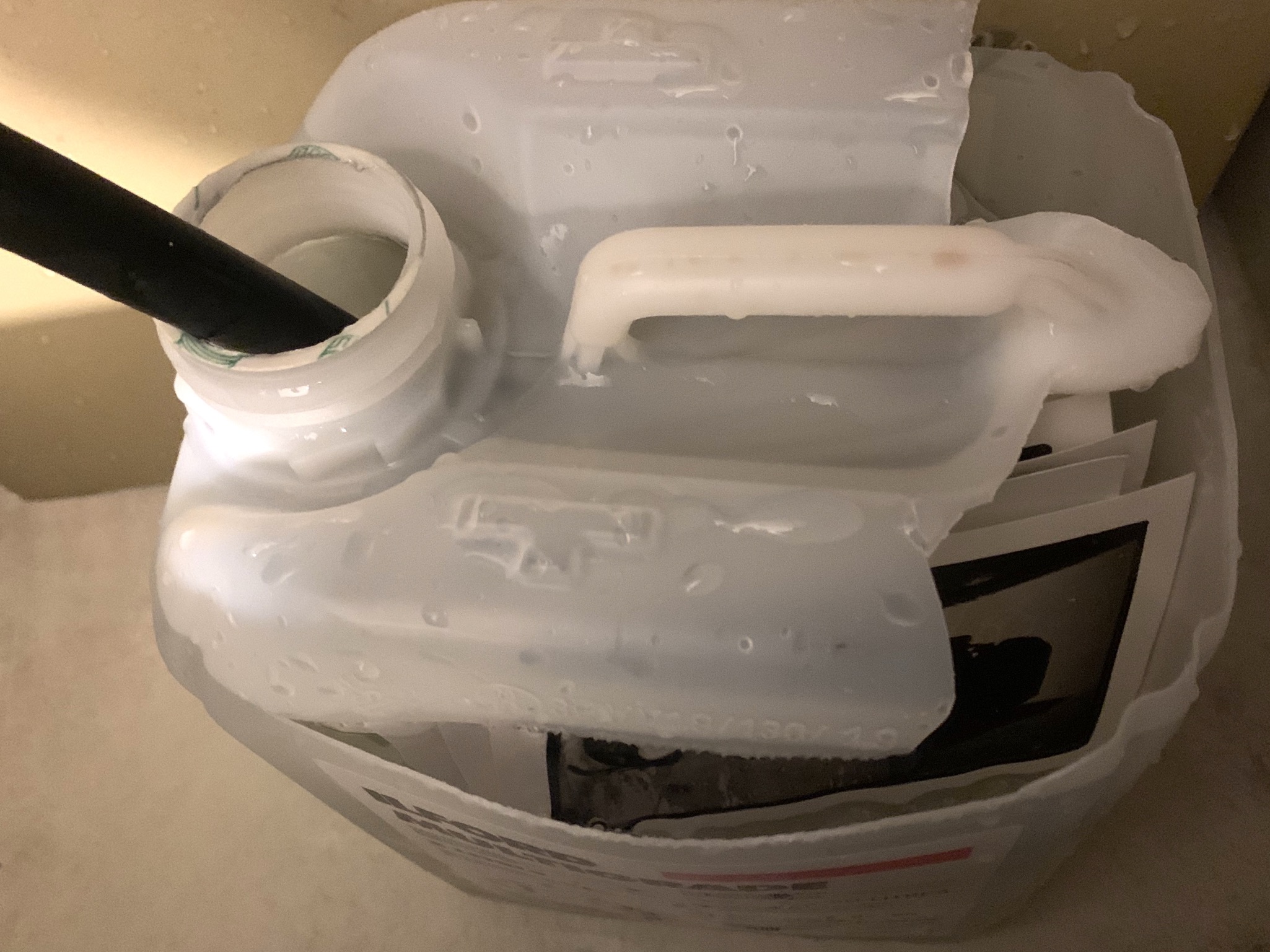

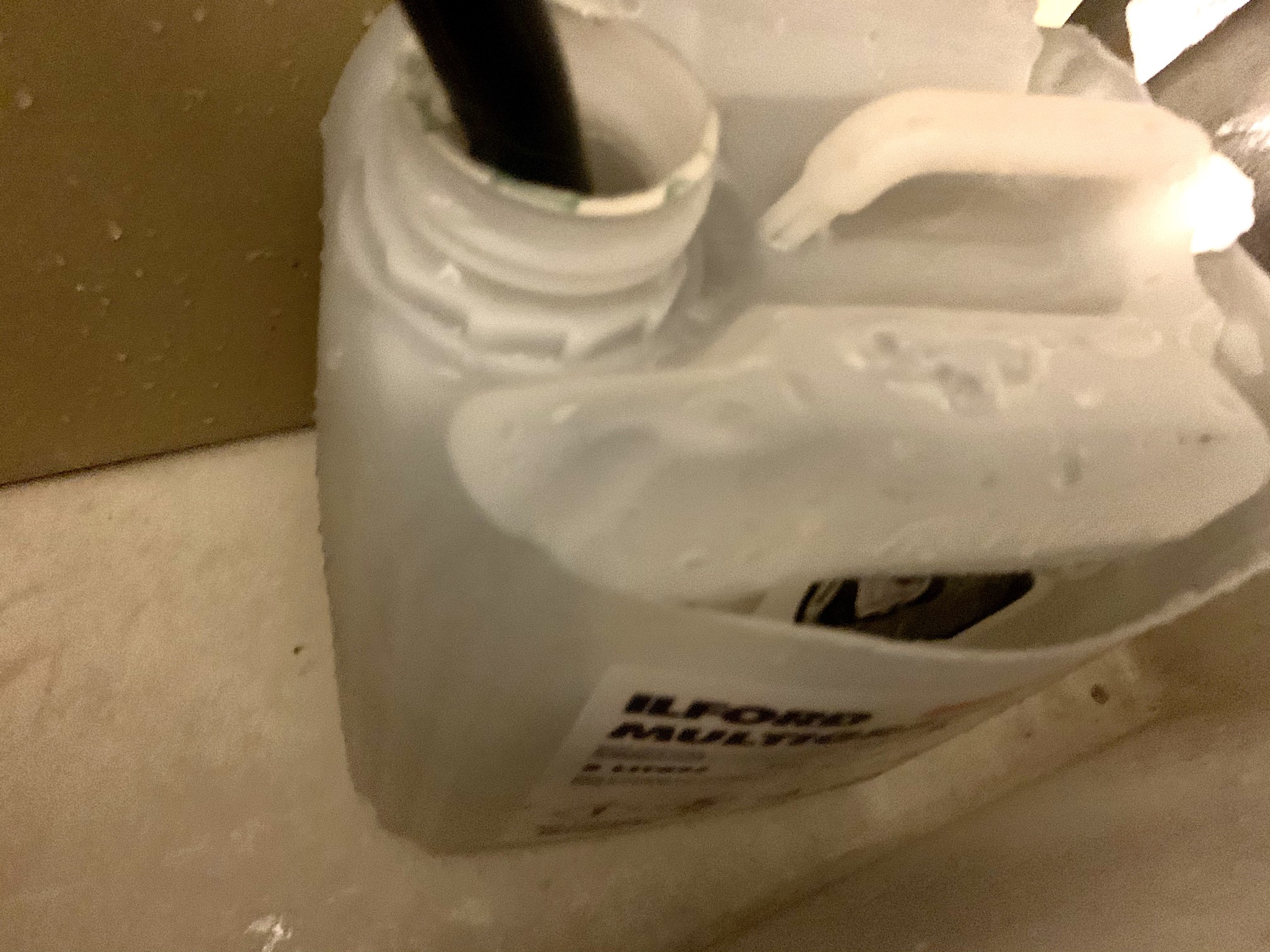

And then I had a rare flash of whit: I took advantage of the extremely fine and intelligently engineered Ilford 5L Bottle and customized it to my needs. Granted, it took me 20 seconds to make, but You have to give the credit to the minds that have created this 5L bottle, with all the exact specifications it needed to have in order to contain chemicals, not break, be able to whitstand shocks, and so on.
Here it is, the Ilford Multigrade washer for papers 4x6 and smaller.
specs and how to use:
-Accepts up to 50 prints. Fill with water with a hose through the lid hole, lift the handle and insert prints.
-great water flow
-empties in 3 seconds, fills within a minute with a 5L/minute water flow. That’s 60 cycles per hour.
-due to the size, the prints stay upside down.
Drill One or Two small 1/8” holes near the bottom in order for water to create its own natural whirl. It will overflow and drain from the little hole(s).
I will upload better pictures soon. I am extremely satisfied.

I’m can’t say how happy I am about this washer. Yes it might look like it’s a piece of shet but it has so many things going for it, it’s simply genius. The right height, right width, great water flow, easy to empty and refill. I really recomend that you cut it the way I did, by keeping the handle on top. It’s the handle that makes the whole thing working by enabling you to shake the washer, and simply manage the washer with one hand.

(note: the handle will give you the possibility to convert the washer as a holding bath until you are finished printing, which you can later move to the bathroom and start washing directly in the sink, by letting water run into it. That’s for those who do not have running water in their darkroom).
Setting up a makeshift darkroom in a toilet or in a hotel room has always been easy. The problematic part has always been the washing. Using trays is not efficient and blocks you from printing more than 5 or 10 prints. This Ilford container solves all. It washes up to 60-70 prints in the upright position, a natural position once the water starts running.
