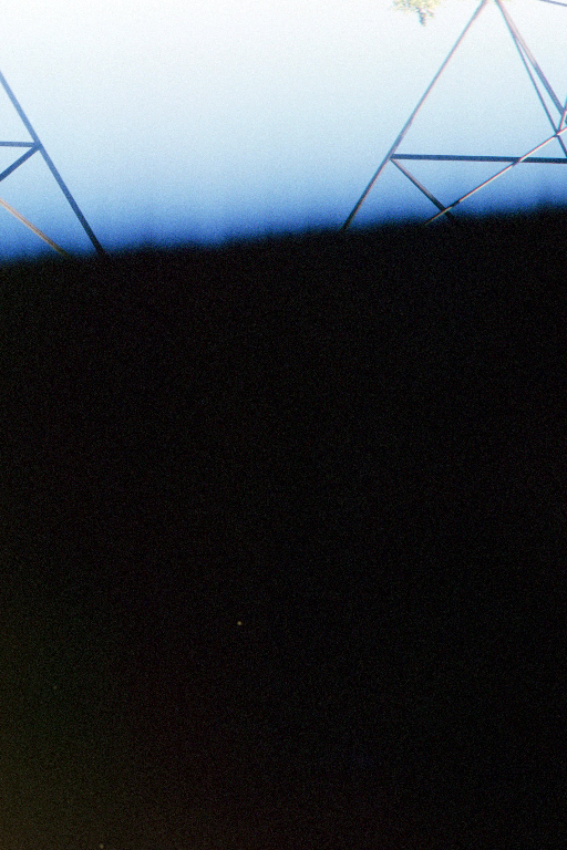

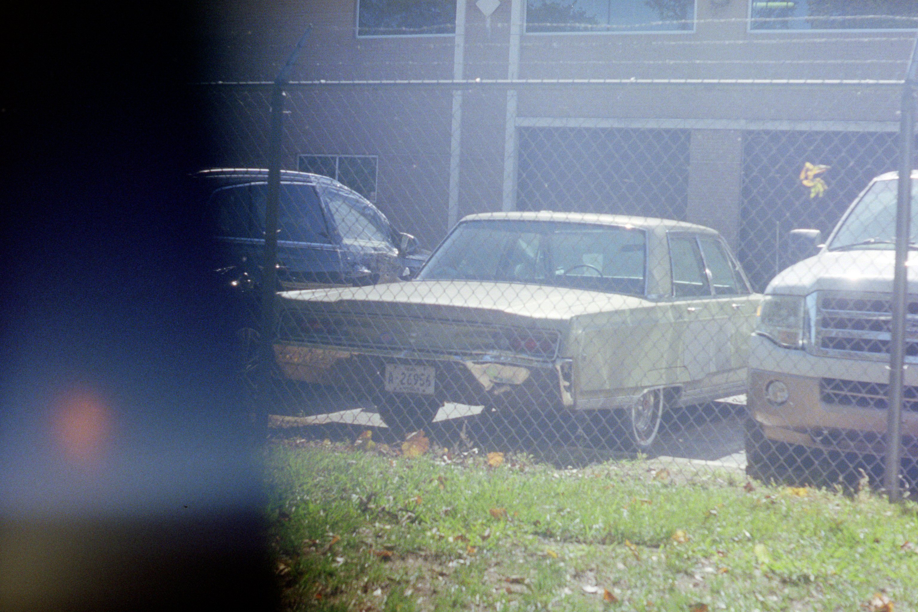

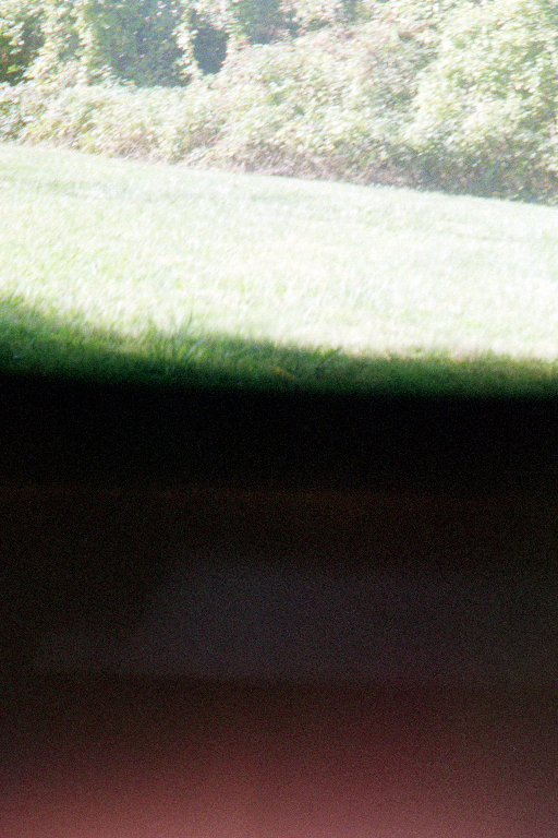

Hello, this is my first post here. I recently bought a Zenit C as i got a really good deal on it, but its been plagued by issues.
First, the mirror got stuck, which I fixed by lubricating the spring. But, when I got my first roll back, it turns out it also has severe shutter capping. And, when I took off the lens to try to look at the shutter, it completely froze up with the film advance knob doing nothing. The mirror was stuck in the up position and the fabric didn't move. It fixed itself later but its still something I want to address.
Do you guys know how to fix the shutter capping? And are there any other common issues I can prevent? Im new to camera repair but I want to learn.
Thanks!!
I've serviced a number of Zenits, though not an -S. At the very least, I'd expect to partially disassemble the camera, flush out contaminants and stale lubricants with solvent, and apply fresh lubricant. When the cameras start to act up, it's common for folks to think they need to increase the spring tensioning of the shutter, but resist that temptation: When all is properly cleaned and lubricated, the original factory settings are all that's needed.
Camera repair can be challenging for a beginner, and I'd recommend that your first efforts be with cameras and lenses you won't feel too badly about scratching and in general, making a clumsy mess of. My own early efforts sucked, but over time and with practice, I began to suck less.
Isaac Maizenberg's camera-repair book can be viewed here:
https://archive.org/details/maizenberg-cameras/mode/2up
Hi, adding oil is not a good idea. It is the old grease that turns to glue, binding up the works. Worst are inside the rollers, which contain the tension spring, powering the blinds.
The only solution is to strip down the shutter mech to get to these rollers. They ten need taking apart to get out the old grease.
There is little or no oil added to any other part of the camera.
My zenit repair guides can be found in the zenit camera club facebook page., however they do not detail a full cla, as this is to involved.
If you want to fix this camera yourself, I would suggest you buy a few zenit E for pennies and practice on these first.
There are these: they refer to the FED/Zorki shutter, which is very similar.
Jay Javier: https://jay.fedka.com/
Rick Oleson: http://rick_oleson.tripod.com/index-101.html
Rick Oleson seems to say many problems come from dirt or film shreds getting in two toothed wheels at he bottom of the camera, so to clean those first before trying anything more complicated. For me, taking the body shell off is complicated enough.
