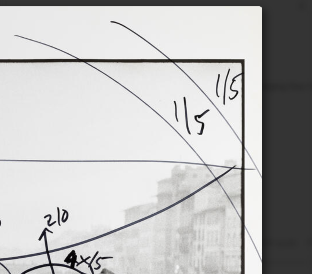

I agree that the squiggles seem like a dodging/burning plan. The odd one to me is that it looks like they may try a crop that places top of frame just at the top of the buildings at left/right corner?
As to the numbers? anyone's guess. seconds, f-stops, filter grades, who knows.
I also don't do this particular style of "print map," but I write a decent number of notes on the back. If I'm going to run an edition I try and get it done in the same session as the "master" for the set.

i take a picture of the test print and final print. Have a word doc template i use to jot down all the things I did. Including dev, times etc.
Ill have 1 pic for each dodge/burn or whatever i do etc in the same order I did them depending on how crazy I got. I have a folder on my laptop with all the prints ive done so far. A bit easier to find, make notes, mark up. For me..
My take is the darker line at the top is the crop, well above the buildings. The second straight line with a squiggly arrow looks like a gradated burn of the sky.
When I intend to print an edition, I usually wait at least a day to check for dry-down effects, plus be able to give the print a good going over for any fine-tuning for the edition--pretty much limited to 5 plus 2 APs. I do try to keep scrupulous notes on exposures (split-grade), dodging and burning. Rather than write on the print, I might make a thumbnail sketch if the dodging/burning is complex. And occasionally, there is a custom mask or burning tool I will have made that I will file away with the negative.

It's the amount to dodge and burn the image in seconds (decrease exposure or increase exposure in the printing stage) to balance the picture, a basic darkroom technique but also applicable to digital techniques as well. So if the sky is too light you burn the area (add exposure), if a face is too dark you dodge the area (lighten the exposure).
Like here of Don McCullin's darkroom notations
I don't know how large this print is, but a 16 minute base exposure time and a 12 minute burn-in time on the rim of the helmet? Am I reading that correctly?

The notation belongs to Pablo Iniro, who was the darkroom printer for Magnum for I-don't-know-how-long. When making prints, it would be important to make them all the same. You can see numerous examples of some very well-known photos here. There's an interview with him here.
@cliveh It's important to remember the guy was producing prints that had to look as expected, from many, many different negatives. So keeping a record of what he did to get the print to look how it did was necessary.

It's fascinating to watch people making silly mountains out of obvious molehills.
This is a graphical representation of why a metronome/ timer that beeps every second is an indispensable darkroom tool, that's all.

Perhaps the photographer didn't do the printing himself, just like Henry Cartier-Bresson...
Perhaps these notes on the (test-) print are instructions for the darkroom operator.
Perhaps, these indications are divisions of the initial exposure time of the print: let's say that the time was 10 sec., then +1/5 would result in a burning in of 2 sec. (=total of 12sec. for that particular area).
This is just some guessing...

Perhaps the photographer didn't print hemzelf, just like Henry Cartier-Bresson...
That's obvious, especially in this case. See the image credit:
Guide print marked with Pablo Inirio's notes for darkroom printing. © Leonard Freed / Magnum Photos
From here: https://www.magnumphotos.com/theory-and-practice/back-to-the-lab/
Yes, they could have been fractional times...if not for the divide by zero error that would result from trying to burn an edge for 5/0 parts of the total exposure....!
5/0: perhaps a writing error (who doesn't), the operator and the photographer built up a certain bond (must be), they understand each other and see thru...
Twice in a row, while other writing errors are scratched out? Doesn't sound like it. Also coincidental that it's either "/0" or "/5". The logical explanation is burning on high vs. low contrast - grade 0 & grade 5.
The figures are all X/0 or X/5
Yup. Walks like a duck. Quacks like a duck. Guess what it probably is!

I won't even speculate on what the numbers do mean, it would be futile.
However, burning with grade 5 here is not only illogical, it won't do anything. You would need to burn with the lowest grade filter to build any density.
When was that photo and/or print made before or after the widely use of multicontrast by professionals?

Add to that that Pablo Inirio (the Magnum printer whose notations have been widely publicized--they are even for sale) seems to be printing from 4x5 dupe negatives. (Look, Ma--no gloves!)

On the Magnumphotos site, the photo is mentioned as taken in 1958 in Florence (by Leonard Freed 1929-2006), no date for the darkroom print.
This photo was published in the book: 'Leonard Freed: Photographs 1954-1990' in 1991, only, we can wonder when the original darkroom printing was done, as Pieter12 pointed out the 4"x5" dupe negative...
But still, many questions are staying open, but must they absolutely be answered, as this fine photo is already so interesting to look at?
