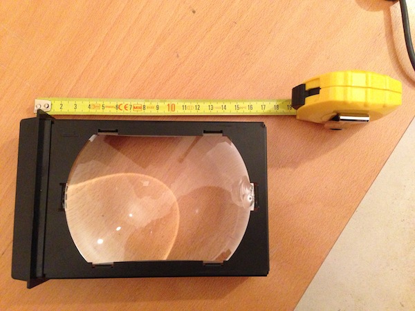

My Magnifax is not model "4a", it's the older one called model "4" (without 'a' letter). And I think the condensers lens have different numbers between models range because my condenser nº1 is the largest I think. Here is a photo I have taken:
Yesterday I did some 6x6 and 35mm with this condenser in 8x10 and 4x6 paper on both formats and I don't notice any vignetting in final prints if it's what supposed to happen. Can you confirm please ?
Thanks.
Hi again.
I exchanged some emails with RK Photographic and it looks the Condenser nº1 i have is for medium format. They say that existed a Condenser nº2 but the former (nº1) is so good to print 35mm that there is no need to buy it. The only difference could be a longer time (maybe seconds) to print 35mm.
The prints looks so good and with this confirmation I won't do anything and keep printing :smile:
Thanks again for the help.
