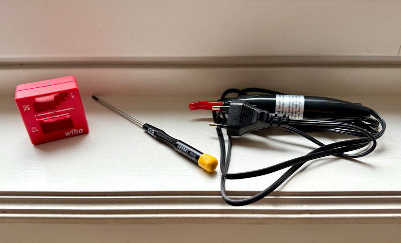

Small screws that you can drive directly into hard-to-reach places with a screwdriver.
An indispensable work aid.
And a screwdriver can be magnetized quickly, for example, with a tool like the one in the picture on the left, which can also demagnetize screwdrivers. However, if the screw itself is already magnetized, this cancels out the effect.
On the right, you can see a choke for demagnetizing tape heads in magnetic tape recorders. However, its magnetic field is too weak for metal parts, at least that's what my tests have shown.
What are your recommendations for demagnetizing screws and screwdrivers?
I use exactly the same tool (the red one on the left).
I use a magnetized screwdriver to position very small screws that I can no longer position with my finger when screwing them in. A very useful tool.

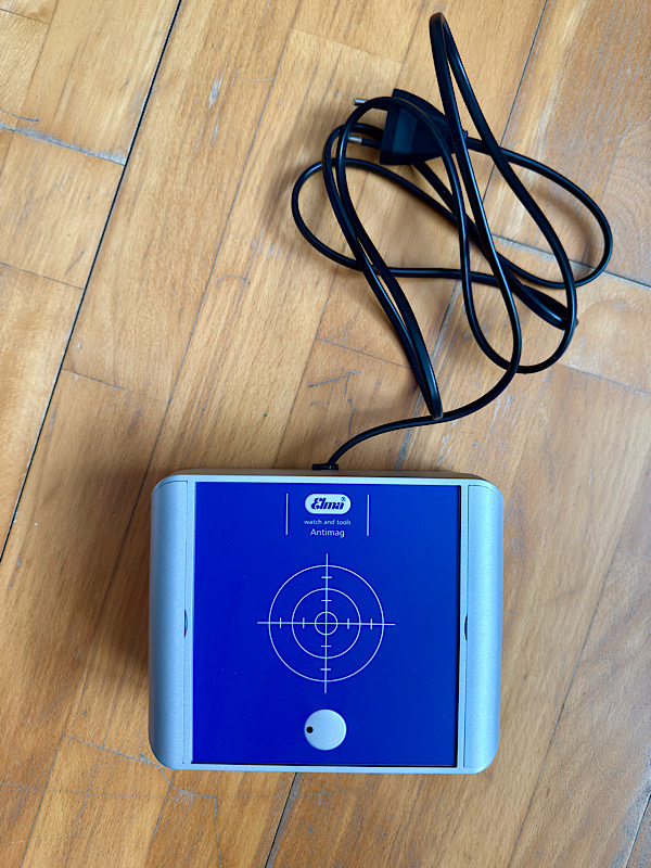

There are demagnetizers that run on mains power. Does anyone use them, and what are their experiences with them?

This is how a commercial powered degausser works. They were once used to quickly erase magnetic tapes (which IIRC could be re-used), and are used to erase magnetic hard drives for security (which can't then be reused).
I found a youtube video where someone examined an unpowered magnetizer/demagnetizer like the red Wiha one in Andreas's first post. It just has two permanent magnets on either side of the magnetize slot. They are aligned to enhance the B-field lines along the magnetize slot. When you draw the screwdriver through the magnetize slot, along the field lines, it gets magnetized. The field lines are more perpendicular to the de-magnetize slot, so I guess the idea is that drawing the screwdriver through the de-magnetize slot semi-scrambles any previous magnetization. The stairsteps in the de-magnetize slot are just plastic and have no function, other than allowing you to tell the slots apart.
