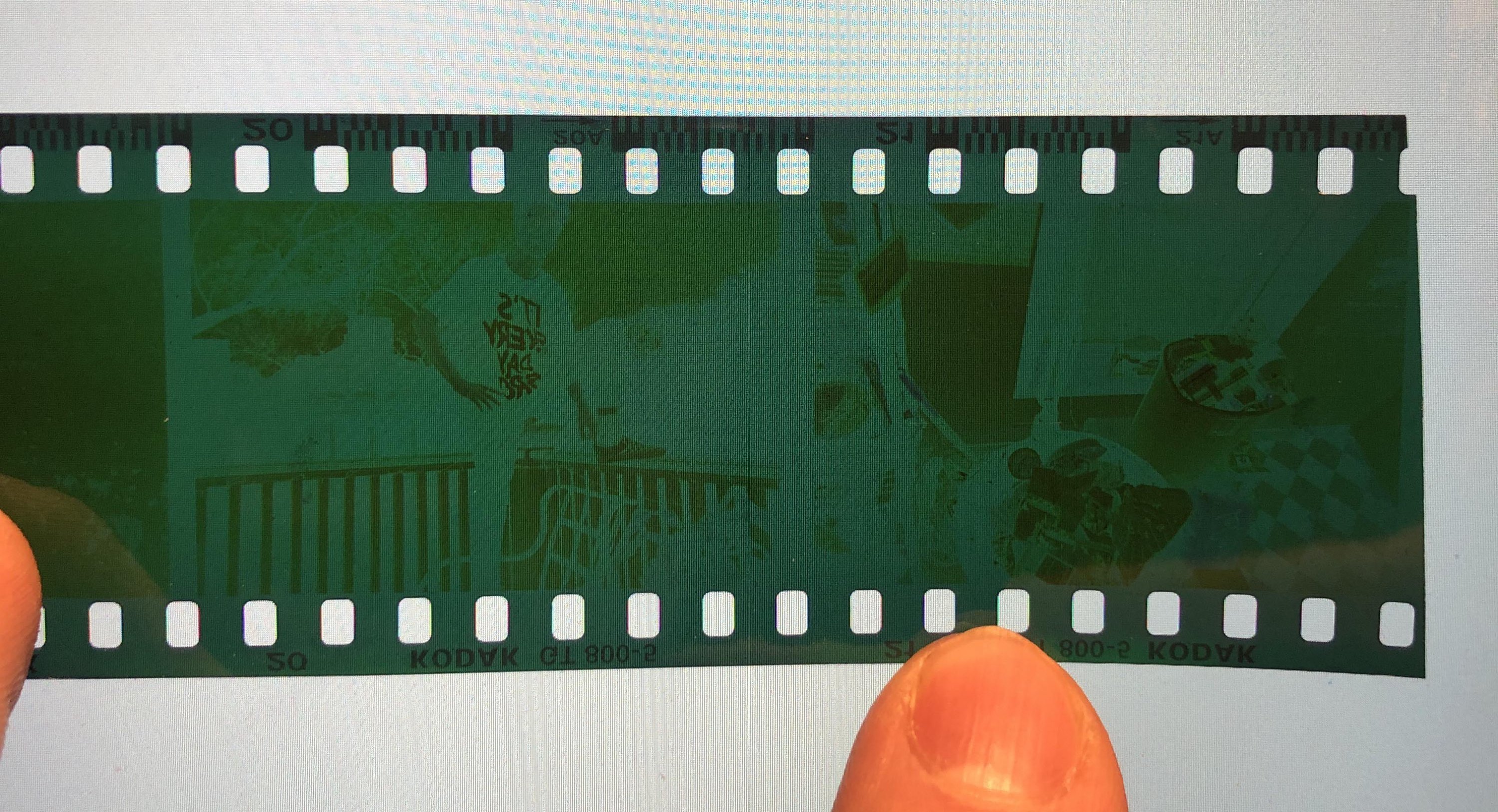

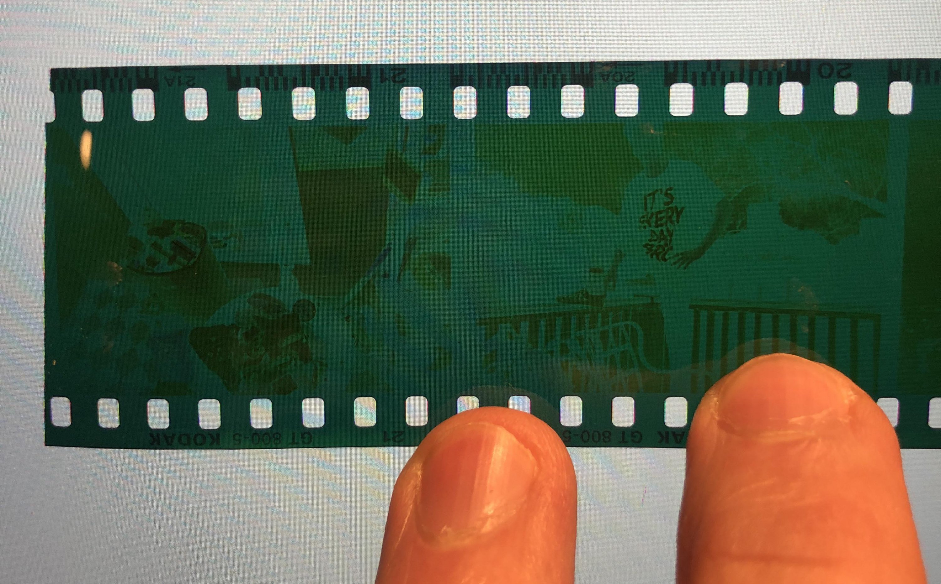

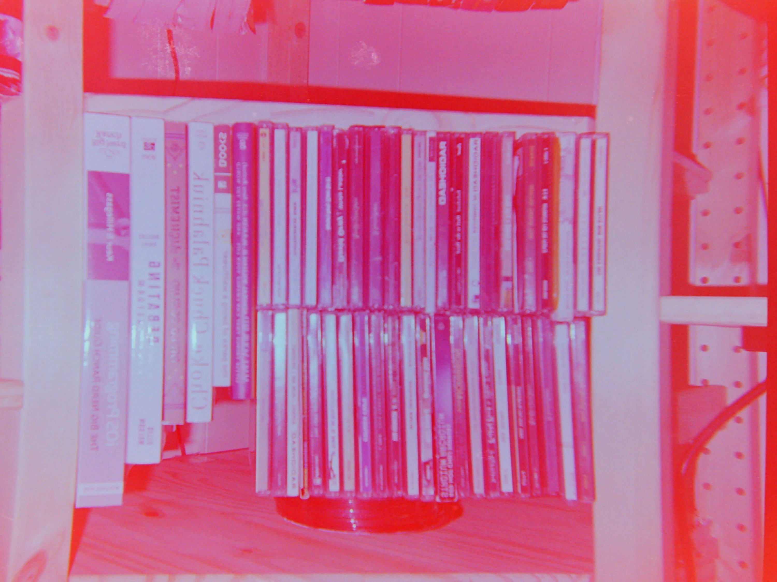

Hey all,
I am new to C41 home processing. Just mixed my chemistry and developed my first roll. Not exactly sure what it was but it was 800 speed Kodak from a disposable camera, that's as specific as I can be. I worked my best to keep temp at 102, as the Unicolor kit I used suggested. Followed instructions to a t, and when scanning my negatives they came out incredibly red/magenta. Ive attached a few scans, I think maybe its my Blix? was going to develop another roll and double the Blix time and see if that has any effect on the coloration. Please let me know with any suggestions as a I am certainly new to all this.
Thanks a bunch

Hmm never saw such issue from c41 development!
But it reminds my about worse expired (damadged films) I ever got from costomer minilab:D!
Sorry I have to quit here - perhaps the color developer was bad? (expired part c of Maco color developer c41 would not cause magenta cast? ) Hmm - no idea sorry never saw such extreme cast!

Could you post a photo of the negatives please? Preferably on a light box or otherwise lit from the back.
I'll post one asap, I was thinking maybe it was my scans. But I really don't see how I could get that much red off a bad scan
Truzi
Mar 18, 2012
2,648
It may just be an issue with the scanning.
It would be easier to help if we could see the negatives.
Can you use a smart-phone to post a picture of the negatives themselves, including the rebate (sprocket-hole area)? Perhaps hold them to a white piece of paper, or against a blank web-browser page (about:blank) for back-light.

jackkguy
May 2, 2019
7
Wisconsin
Both sides of the scan, Don't know if this will help much. Any suggestions greatly appreciated

I used a safelight from B and H, but maybe I had some extra light creeping in
Just out of curiosity, what made you think that there was a "safe" safelight for loading C41 into a reel. Was this the first film processing of any kind you tried i.e. you had not done any B&W film processing previously?
In fact for all practical purposes C41 and B&W film share the need to be loaded in total darkness. Frankly I am surprised that the C41 negatives came out as well as this under your B&H safelight. What safelight was it in terms of colour and what did it say it was safe for and and how far away was it from the film when you were loading it into the reel?
pentaxuser
Yeah no total rookie, I'd never learn if I didn't juts go out and try it on my own. I bought this one https://www.bhphotovideo.com/c/product/15766-REG/Delta_35110_Brightlab_Universal_Red_Junior.html Sounded like it would work, but I was loading film within inches of the light. Could it really be this simple?
Kino
Jan 20, 2006
7,741
Orange, Virginia
Yes, that simple. No light. Period.
I am amazed you got anything at all from that roll...

You probably don't realize it, but the diagnosis of your problem, namely:
Looks like red safelight fog.
PE
comes from someone who really, really knows of what he speaks :D.
Just think of this as an opportunity for both learning yourself, and teaching us some too.
Those results are considerably better than I would have expected.
