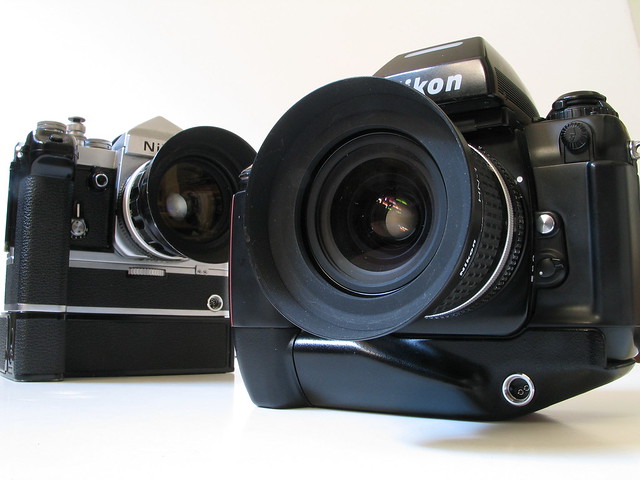

Nikon F4 & F2
by Narsuitus, on Flickr
The Nikon F was my first Nikon SLR. I replaced it with the F2 in 1971.
The Nikon F3 was my first Nikon SLR with auto exposure control. I replaced it with the Nikon F4 when I needed auto exposure control and auto focus. Today, I still use the F2 and F4.
My F2 and F4 both work well for low-light shooting. Both have viewfinders and/or focusing screens that I can remove and replace with whatever I need for low-light shooting. Both have 100% viewfinder accuracy which I find very useful when shooting medical and scientific subjects, flat artwork, and architectural subjects.
When I need to use a built-in light meter, the F4 is my preference because its standard viewfinder has a built-in light that illuminates the viewfinder information.
One problem I have with the illuminated viewfinder in the F4 is that there is no way to turn off the light. When the illuminated viewfinder interferes with my ability to see under very dark conditions (such as when the camera is mounted on a telescope), I prefer to use the F2.
The fast lenses that I usually use for low-light shooting are the Nikon 35mm f/1.4, the Nikon 50 mm f/1.4, the Nikon 85mm f/1.4, the Nikon 135mm f/2, and the Nikon 24mm f/2.
