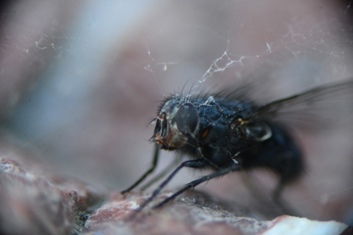

This is a digital image, but illustrates a similar configuration. Nikkor 105mm + 1.4x TC + 68mm of extension tubes.
