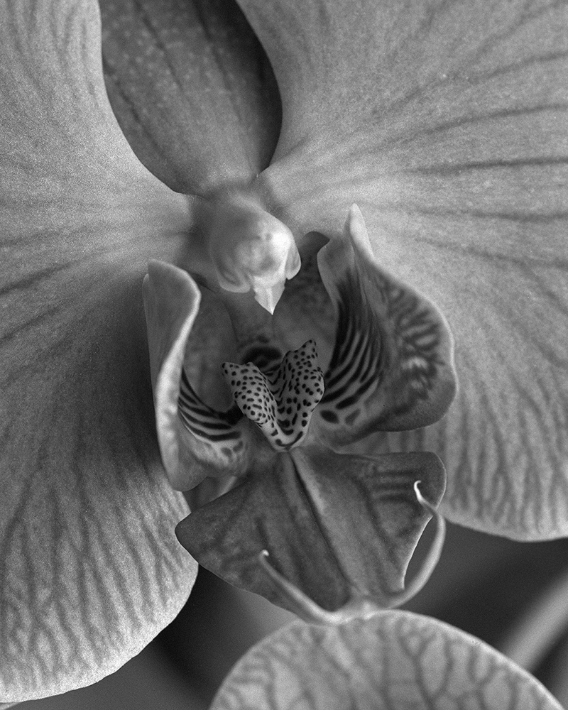

Perhaps close up diopters are an option. At one point I had a Wollensak Optar 135mm for 4x5 and ended up with some old Kodak diopters (called "Portra" filters) that fit the series VII adaptor, so I tried them out. The diopters tend to shorten the focal length. Here's an example with the +1 diopter (not full frame, about 1/4 of the frame). I imagine for something as small as a fig with the long focal lengths for 8x10 you would need to cascade several strong diopters and would probably want more expensive multi-element corrected versions.
Orchid Macro by Howard Sandler, on Flickr
