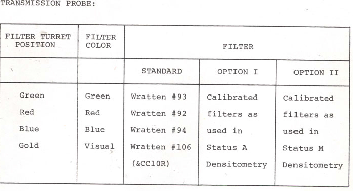

Yes the V is visual channel.
Edit: the following is all wrong (it’s a 106) but leaving it up as a reminder of my misconception….
It has a Wratten No. 90 filter over the photomultiplier tube sensor.
Not surprising that’s the same filter used in Zone VI viewing filters. I think scientists selected its properties of reducing colors to visual monochrome before Ansel Adams decided it does a good job of previewing how things would look in black and white.

Ok I am wrong. It’s a 106 not a 90
I hadn't seen your post before I added that old table, but I think the two filters differ only regarding the properties of the particular photocell used at the time. Likely current or less ancient machines use the 90. My old Macbeth manual actually states the 106's are different for transmission and reflectance and warned about interchanging the wheels.
I think I got my impression from taking apart the densitometer for cleaning and what I saw looked like a 90. Even my instructions manusl mentions the 106 and Kodak Filters says the 106 is for visual readings in densitometers… while the 90 is for monochrome viewing.
I’ve been wrong before but this time I made the whole thing up.
