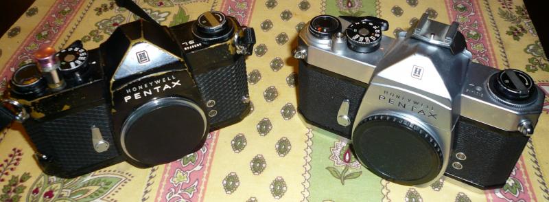

My SL bodies:
The black body is highly modified: Nikon P screen, Ritz rubberized covering, Pentax LX lower front strap lugs added, Leica Screw-Over cable release, and a film reminder holder on the back.
The chrome body is pure stock.
