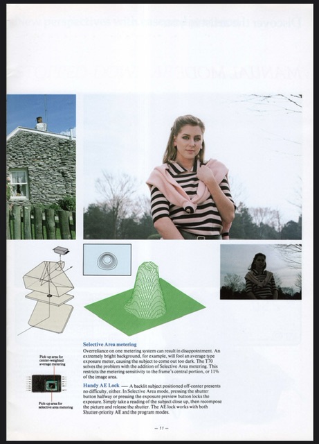

The “spot meter” in the T70 is more of a “selective meter” since the spot is quite big. So the idea is to put it on the subject at an appropriate place to not have strong backlight or sky influence the exposure.
Okay, yes -- the photo of the model in front of the gray sky is a good example of where a spot meter would work over a center-weight, though you could also accomplish the same thing by moving closer to the subject to meter then farther away to shoot. I still think it's a rare one, though. And one does need some averaging here. If one (to take an extreme example) were to spot meter off either the white or black stripes on her shirt, the exposure would be off. Spot metering off her face would work (though not if her complexion was much darker or lighter) but hair and eyes would be no good. This is a situation, I think, where one needs to know one's meter, and that a bright sky requires either opening up a couple of stops or using fill flash.
