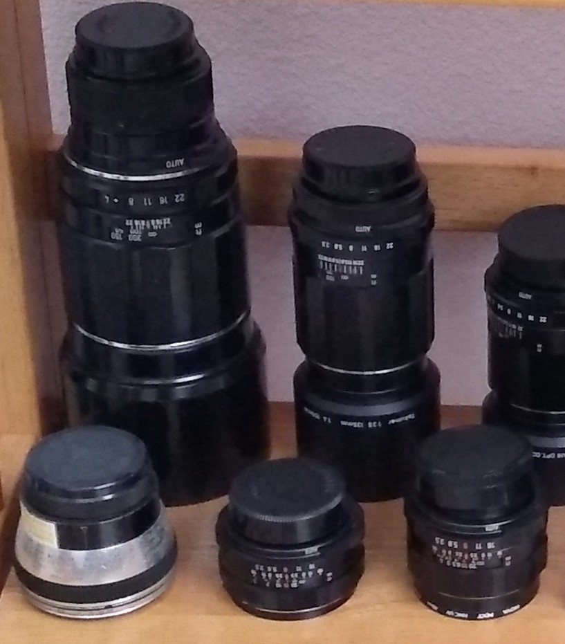

The silver barrel lens at lower left is a Kilfitt 40/2.8 Makro-Kilar D in M42 mount; it focuses to 1:1 (the E version is 1:2).
I've used this lens on my Pentax SP500 - the optical quality and bokeh (at lower magnifications) is astounding. Several photos made with this lens decorate my wall.
On my SP500, I have to limit the distance it will focus - at infinity the mirror will hit the lens. At very close distances, there's no danger. So, I've put a paper "stopping point" on the barrel. On the Spotmatic, this isn't an issue. People having this lens should check for interference (I can explain how to do that safely).
Kilfitt lenses have amazing optical quality.
