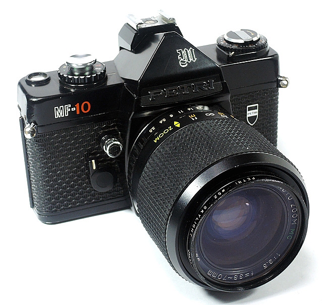

- Petri MF-1
Oh dear! It is really the smallest M42 camera ! It looks just like a toy!
Not uncommon but rare to get one in right working condition.
The Petri CC Auto lens is nice. However, one of its lenses (45/2.8) is too plastic and the previous user has broke the internal nylon holders .
This camera is small, simple. The slow speed gears are located at the button-center. Mine is a easy fix by few drops of lighter fluid and go with the run. It does sound loudly from this little toy.
The metering button is at the Front (right side) and it can be kept pressing "on" with a small turn of the button . But the meter needle reading is another story: the needle rest at the center of the circle , and with flip / swing when changing shutter speed between each clicks. It is a bit scary when stopped in-between the speed and seeing the needle flipped up high.
I believe I would keep one , probably for display and collection, and sell the another one.
