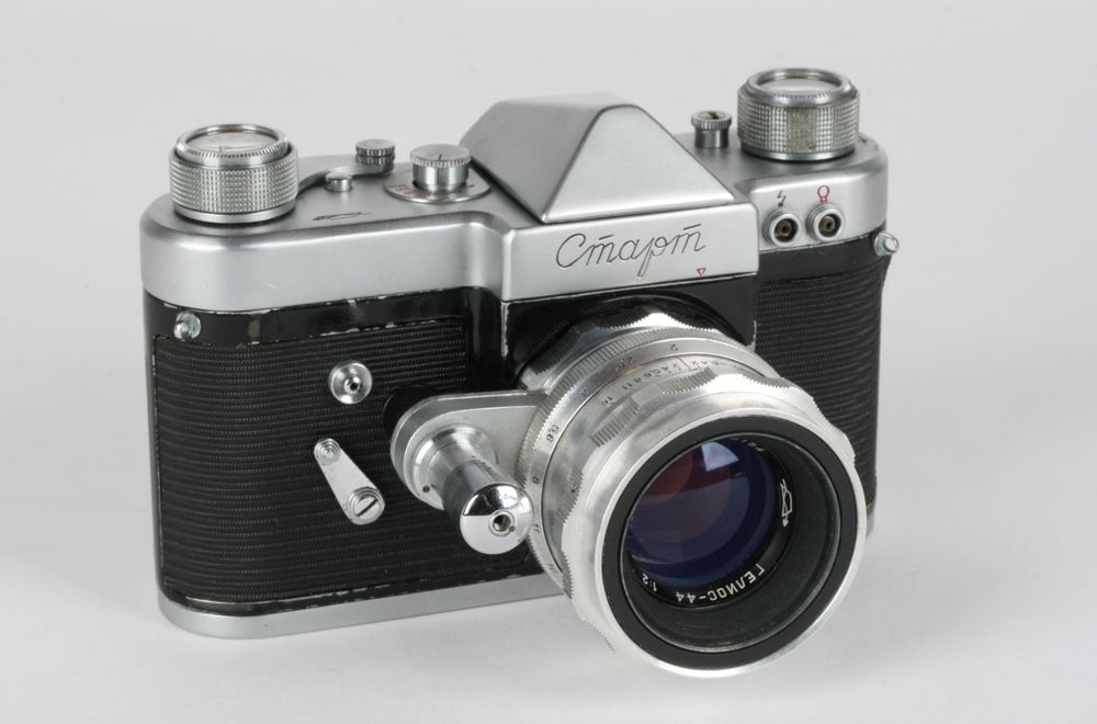

Also the rarer camera called 'Start' A bit like a cross between an Exacta and a Zenith, so long as it has the M39 adapter because otherwise the fitting is a unique bayonet. Another Krasnagorsk model. I had one a few years ago, well many years ago and I shall make no other comment except to say it was an 'experience'. I have actually seen a few of them on E Bay recently and seem to mostly come from French sellers. Better built or should I say more refined, that is if you can refine a house brick! F2 58mm lens and a full range of shutter speeds, plus auto diaphragm on the lens
BMbikerider
Jul 24, 2012
2,941
UK
Here is am image of the Start camera as described above Mine wasn't as nice looking as this!
