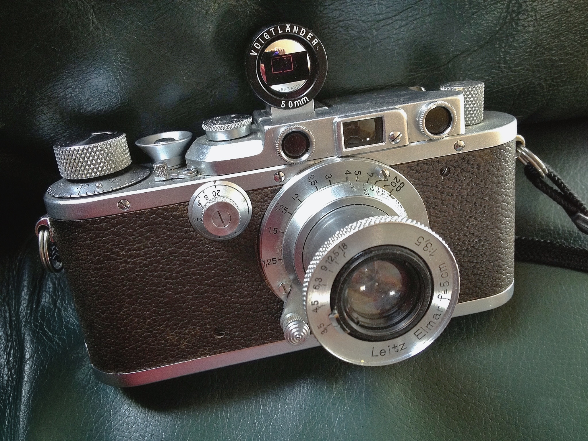

frank
Dec 6, 2002
4,359
Canada
Even with a 50mm lens, an external finder is nice.
