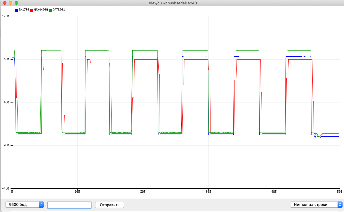

BH1750 (GY-30)
Max44009 (GY-49)
OPT3001 (CJMCU-3001)
Scale Y in EV numbers.
EV (100) = sqrt(lux / 2.5)
Max44009 (GY-49) showed the most unstable results, but it is more sensitive in low light than the BH1750.
The OPT3001 was the most sensitive.
Don't understand much in that plot. Are you expecting comments?
Scale Y in EV numbers. EV (100) = sqrt(lux / 2.5)
EV is a log scale. So sqrt function does not belong here. Plus, EV is a combination of shutter speed and f-stop, with EV0 for f:1 and 1sec. What measures light is LV. We have LV=EV only for ISO100 film.
Why should the various sensors' sensitivity be measured in EV or LV?? I suppose that, to compare them, they are all subjected to the same illumination, and that sensitivity is judged from the electrical signal (current or voltage).
What is represented by the horizontal axis? What happens between the "high" and "low" steps?
Just for convenience. In the "lux", small peaks of volatility are not visible due to too much data difference. And also in order to make it convenient to compare the readings with the results of measurements with a Sekonic L-308 (the closest results - OPT3001, at level 0.1-0.3 ev).
Of course, all sensors were tested simultaneously, under the same lighting and power conditions. "X" axis shows time. Data peaks means turning on and off an additional lighting.
Is this to test their suitability for flash photography exposure measurement? What are the units on the x-axis? Milliseconds?
I don’t think it will work like that. Unfortunately, the response time of such sensors is too long to respond to the speedlight impulse.
