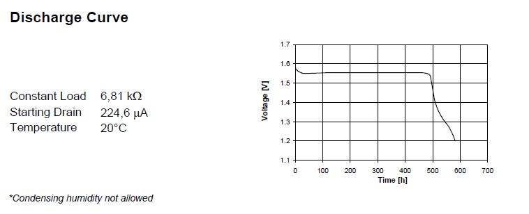

Instead of the SR44/357 battery I use the SR-43/386, where the discharge curve seems quite flat and the meter performance seems quite stable. The minor height difference between the two cells doesn't seem to matter. Even with the less-flat discharge curve of the 357, I'm not sure it matters much given the "allowable variance" of most photographic applications.
From the Renata spec:
Yes, if this curve to be trusted, the SR43 is quite a bit more superior to SR44, so for these battery non-linearity
of the curve can be taken out of discussion. Only the diode's limitations remain. Good find!
