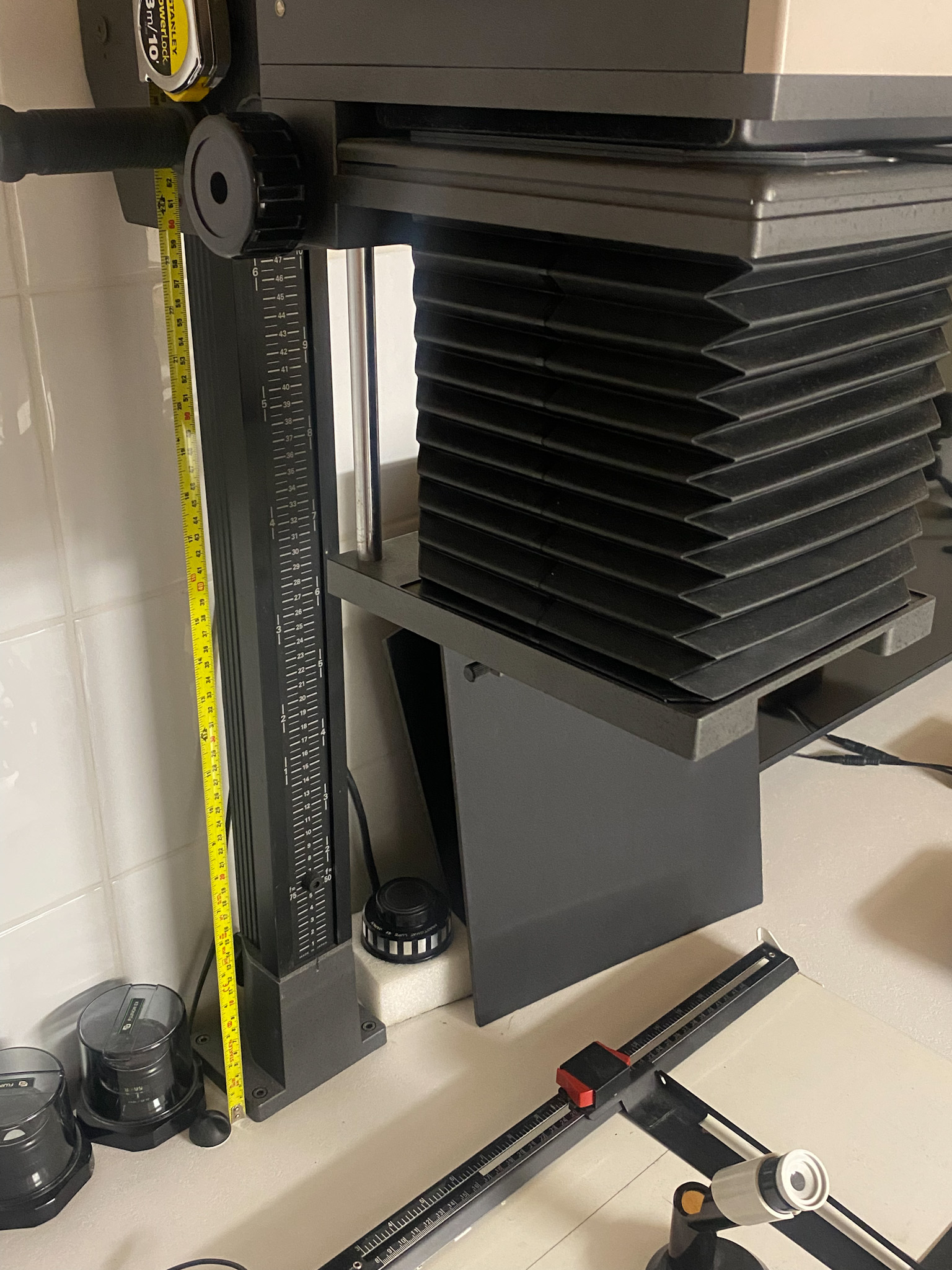

I can give some comparison with my 7450 with a 135mm lens on a recessed lens board. Enlarging a 4x5 negative to about 8x10 (and in focus) I seem to be about 60% of the way up.
Lens is 41cm up from baseboard.
Enlarger reads at 48cm (tape measure reads 60cm from baseboard)

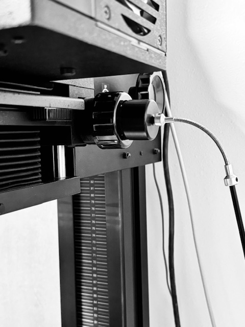

Flexible knob extenders are a moderately common item for amateur telescopes. Depending on the knob design and the size of the shaft, you might be able to replace the knob with an extender that clamps onto the shaft, or you might wish to graft an extension onto the existing knob. Here's an example - I don't have any experience with this company myself: https://agenaastro.com/agena-flexible-slow-motion-cable-with-rosette-handle-13-5.html

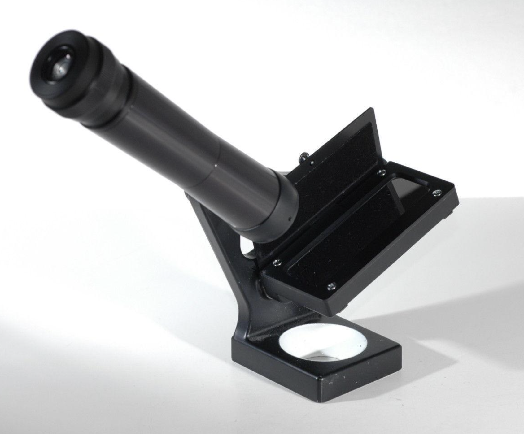

The Magna sight mentioned earlier is similar, and works well, no bending over to see a magnified view.

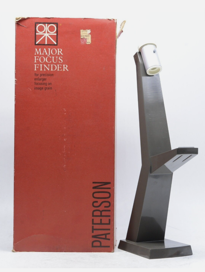

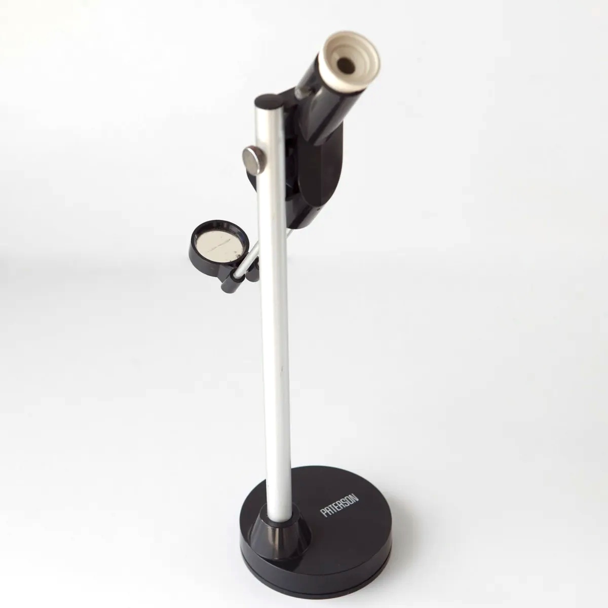

Patterson Major (two different styles) and Micromega Long Reach:
Consider a
Magna Sight Enlarger Focus Scope​
and stand tall. I swear by this
Hey Bill, this seems to out of production. I spoke with Kevin at KHB and he is back-ordered, maybe permanently.
