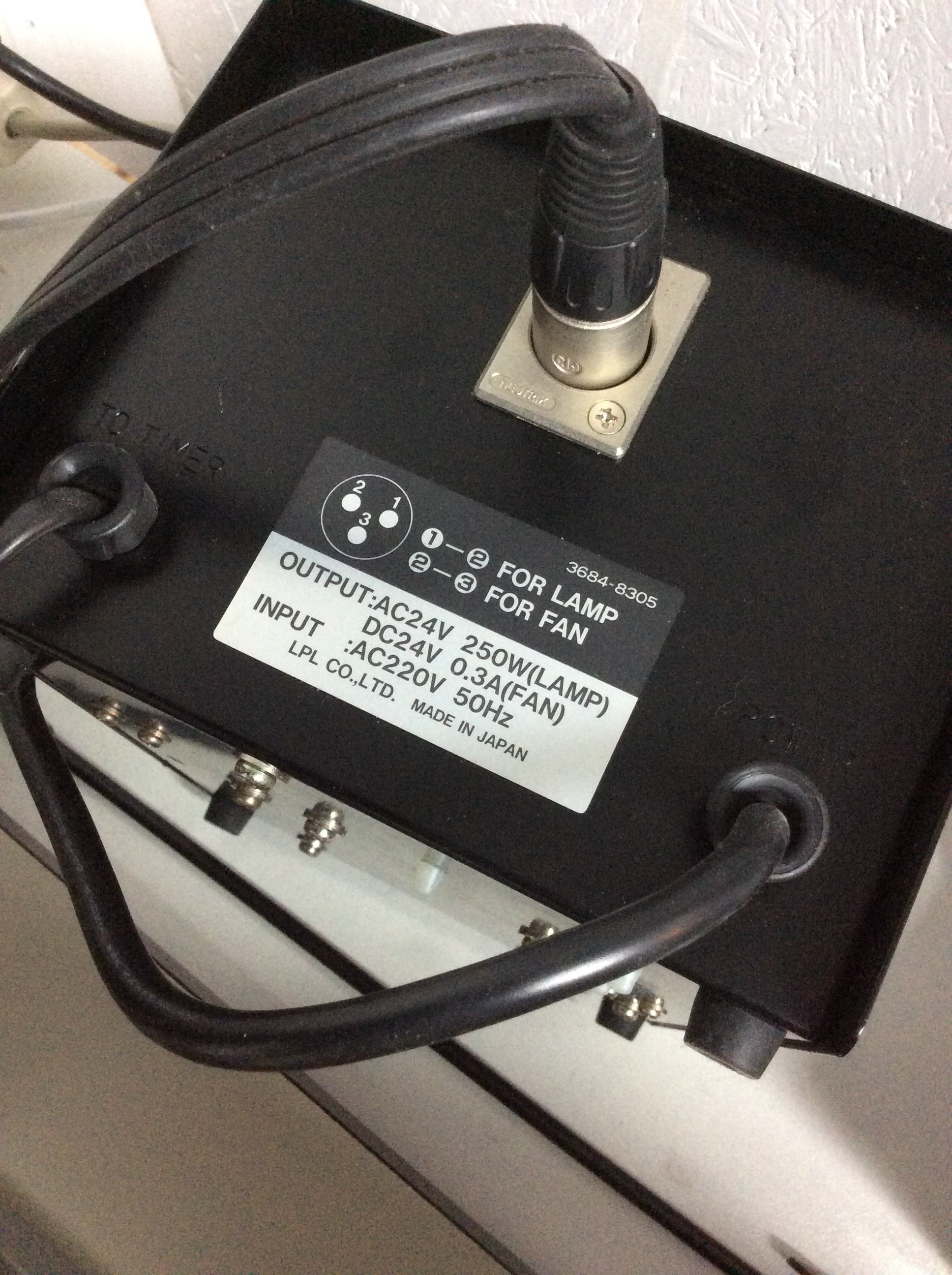

This is what the back of mine looks like, maybe it helps.
Regards,
Frank
