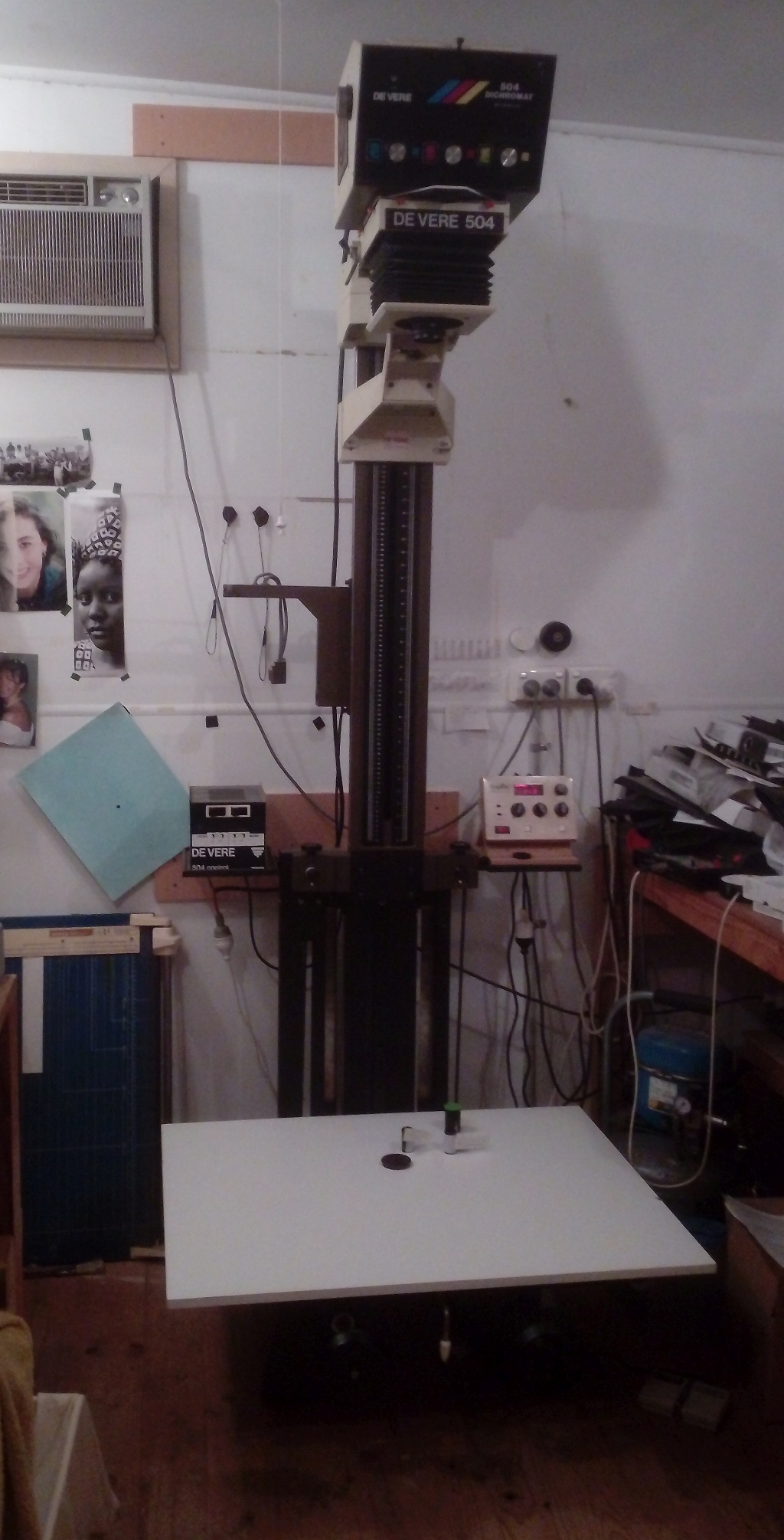

I just went into my darkroom to conduct an experiment with my De Vere 504 with my 150 Componon S lens fitted and the 4x5" negative holder in place. The maximum height I can get the lens from the floor and focused on the floor, was 1900mm. Image size was 1300mm wide by about 1010mm. I say about as there was a bit of fiddling required to get a correct image size. Regardless, the image was cut on the long side by the enlarger column.
The drop table on my De Vere does go down about another 200mm, but I didn't need that to get a focused image on the floor. Just a quickie image from my little Android phone.
If you look at the wall in the background, you will see two light brown pieces of MDF attached to the wall, these are the wall mounts that took the LPL wall mount kits last century. :D
