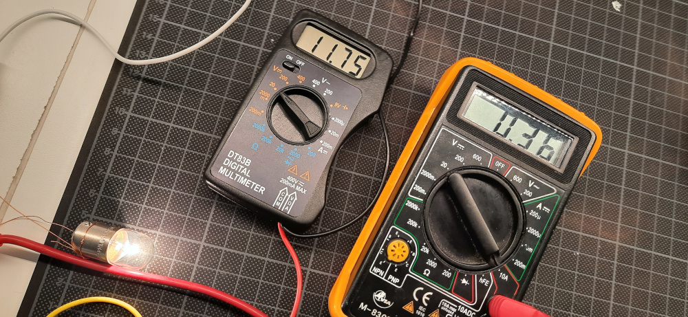

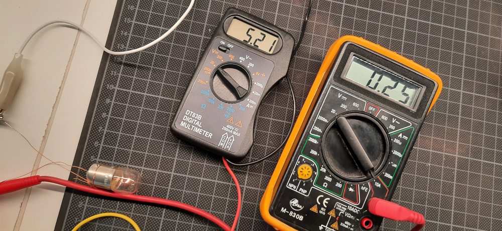

PS: couldn't resist. Evidence of the bleeding obvious...
12V rated bulb (5W nominal) at 11.75V & 360mA = 4.23W
Same 12V rated bulb, now at 5.21V draws 250mA, so 1.3W
Oh, in case you're wondering, the power supply used is rated at 10A at 12V and 16A at 5V. Not quite sure what other kinds of smoke & mirrors you're about to diss up, but from my perspective this would be a good point for you to throw in the towel. Yes?
Oh, and this gem...
[...] if power draw out exceeds power input something in the input or output burns out oft times quickly.
Please do explain how the output power of a system can exceed the input power. I'm all ears. I'm sure the people at CERN and ITER would be very interested as well. Free energy for the people!

*sigh*
Whatever mate. As long as you'll never do any electrical work a where near me it's all fine.
Oh, and this gem...
Excellent demonstration, thanks for going to the effort of setting that up to show us. Good to see Ohm's law is still working well after a couple of hundred years, well maybe not that long!
