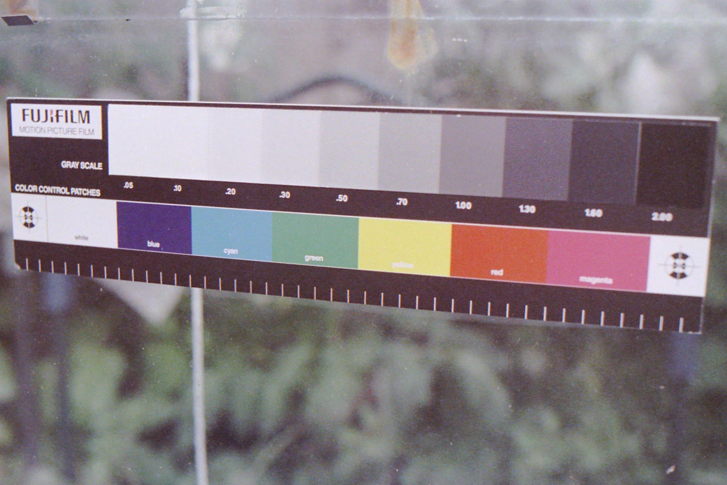

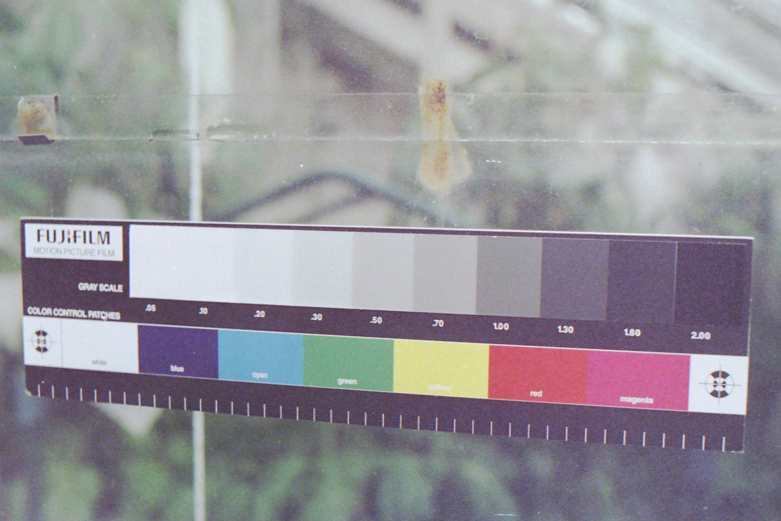

Thanks for the tips. I processed 2 35mmV3 and a 65mmV3. following your way of remjet removal. Same as you, I hung the film. The first try I had missed bits, the second attempt was a lot better, I think with practice it is a good way to do it. The 65mm was a Pig to deal with, the film had been on the roll for months and wanted to curl and twist when I hung it on the clips. Wider clips would make life a bit easier, maybe I could use wide 'bulldog clips'. After the film dries I use Mr Muscle Glass cleaner on kitchen towel to wipe the film back. I am going to add that step into the removal step after drying with paper kitchen towel. I have 400+ft of very old EXR I can uae that to practice in the light, the backing on that stuff is a nightmare to remove.
Here are scans of today's results. They are a little light because when i plug in the scanner it is auto set to +20 brightness, I always forget to zero it :sad:. But it's the grain and colours I am really interested in for now.
First up is V3 500T, next is V2 500T. Both films shared the patterson tank.
I think the V3 film is a little better though not great, that stuff is over 5 years out of date. I really think fresh vision film is the way to go for me. I have loads of old Fuji Eterna that has the same strong grain issues.
I'll do another test tomorrow :smile:. I think your backing removal suggestion is very good and I'll be doing it your way from now on.

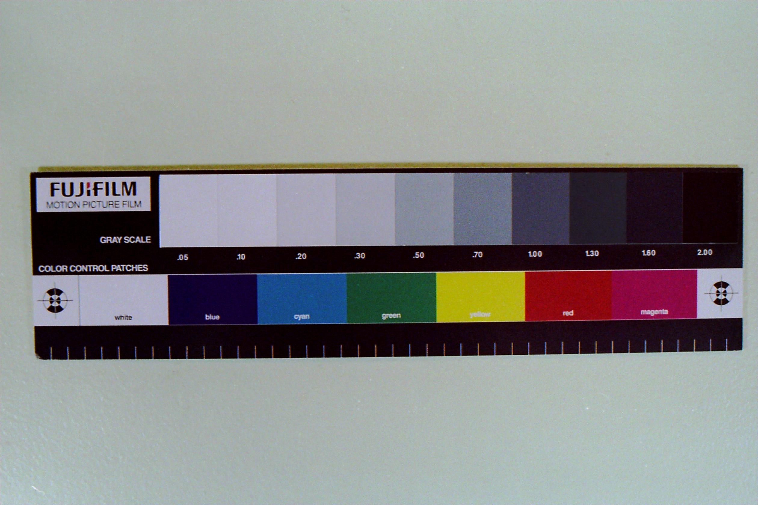

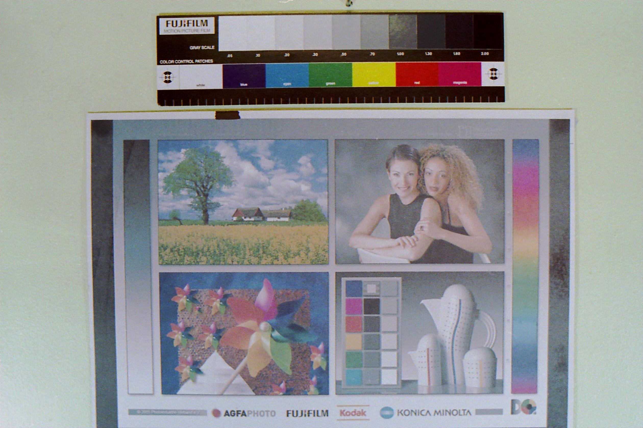

I got some very fresh V3 500T. It has made a world of difference. Please have a look at the scans.
The grain and colours are a lot better.
I can see from the food cans that the colours are a little off, could be the cheapo scanner or the processing temps were off a little.
