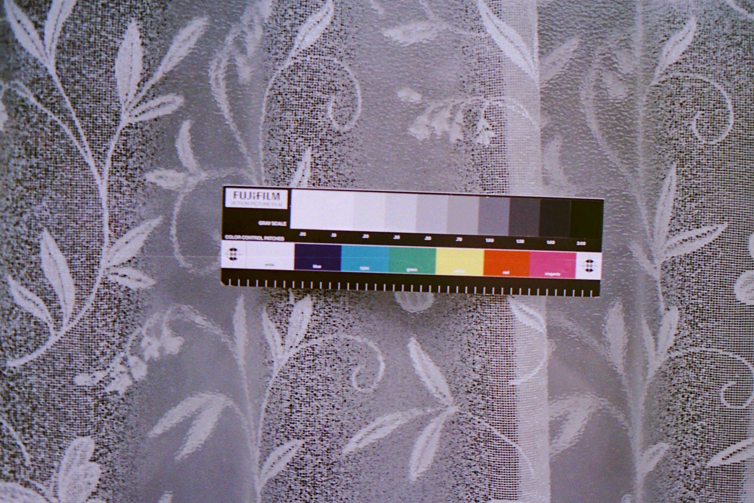

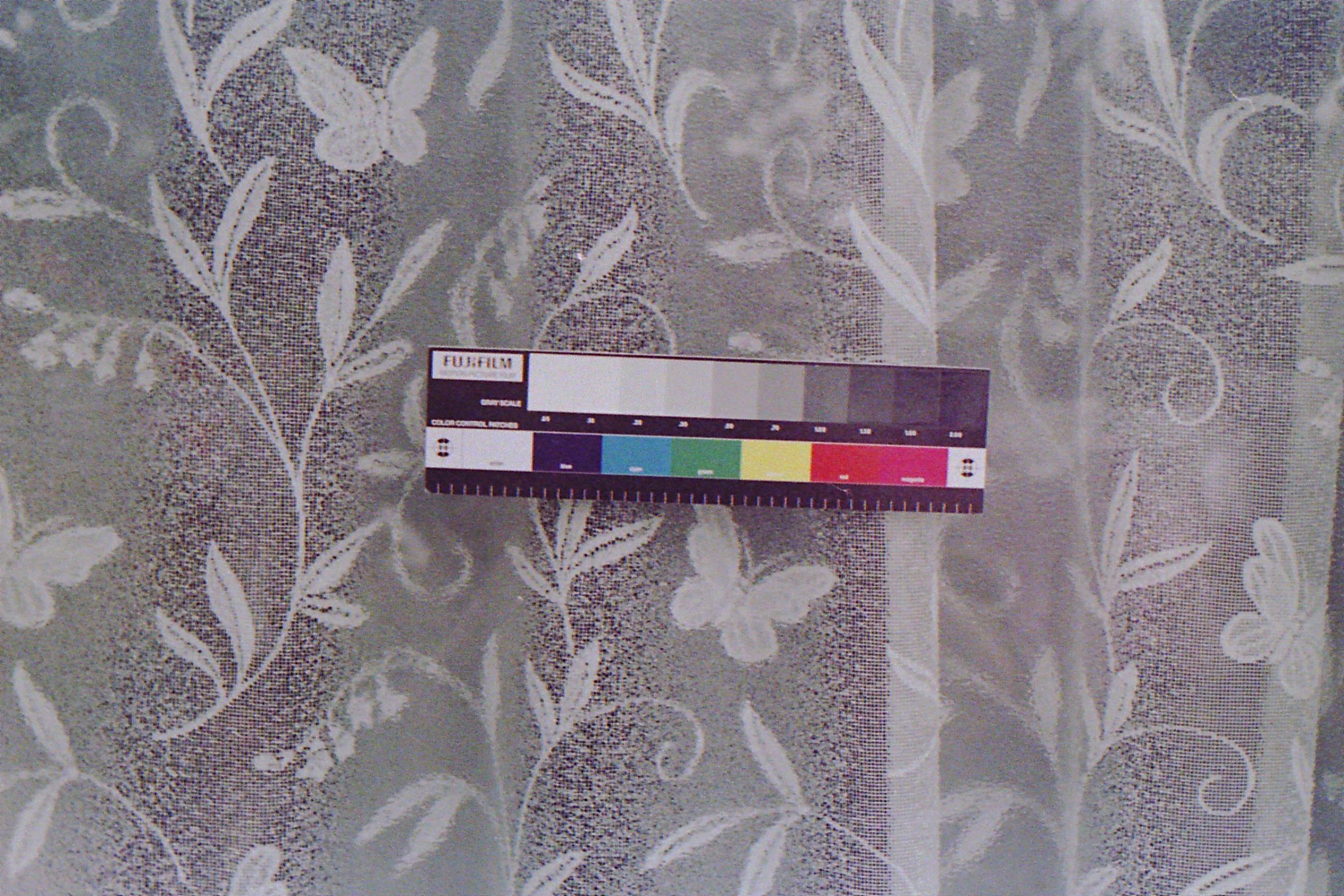

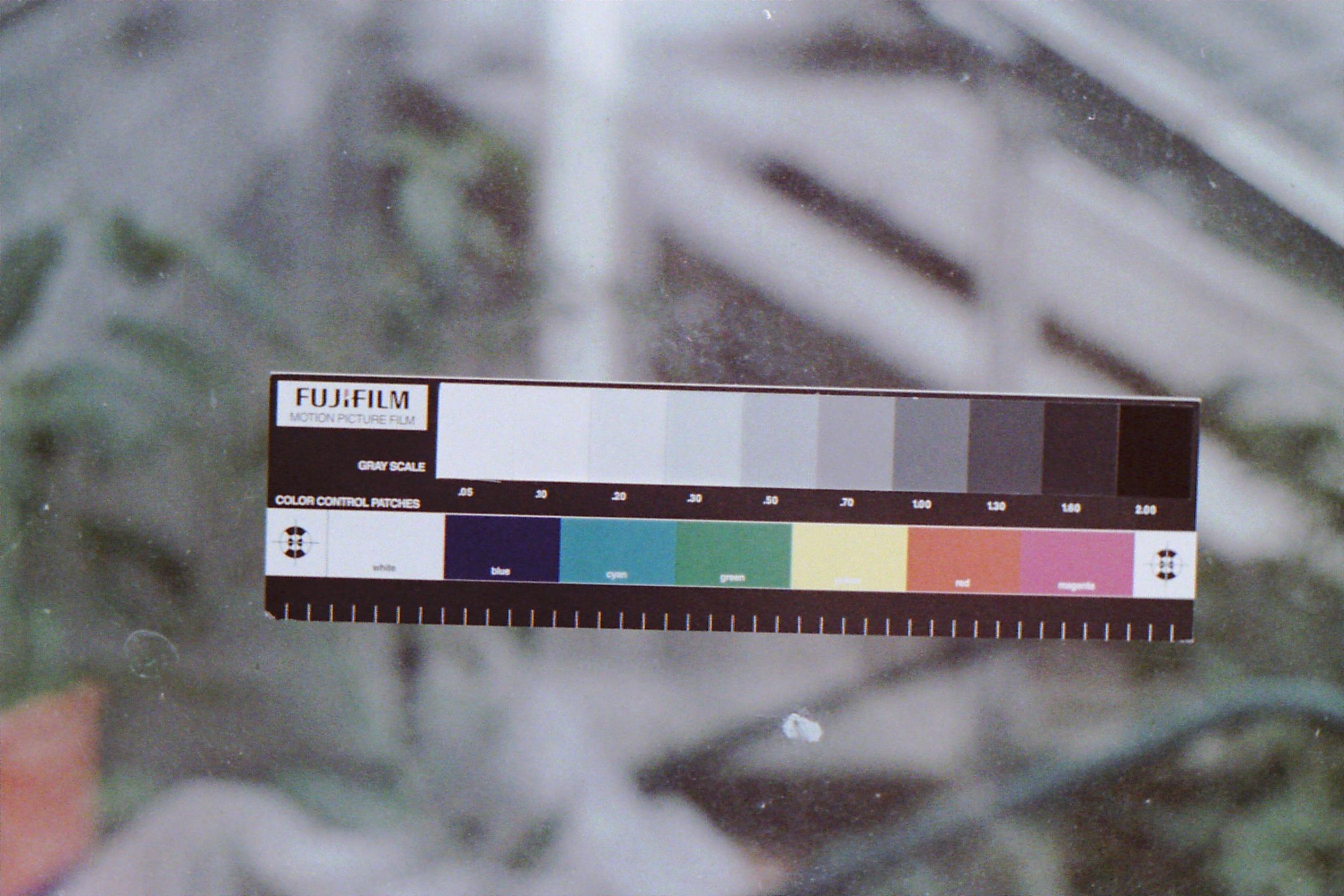

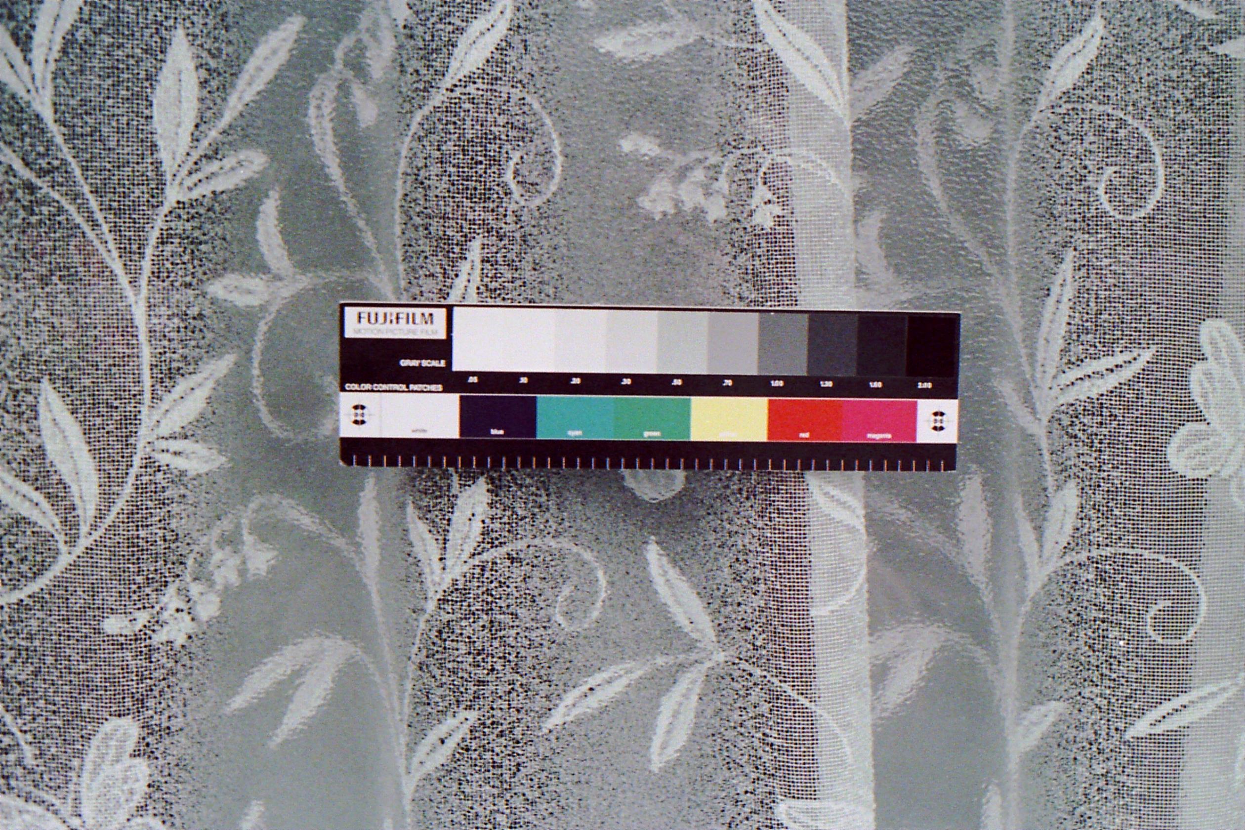

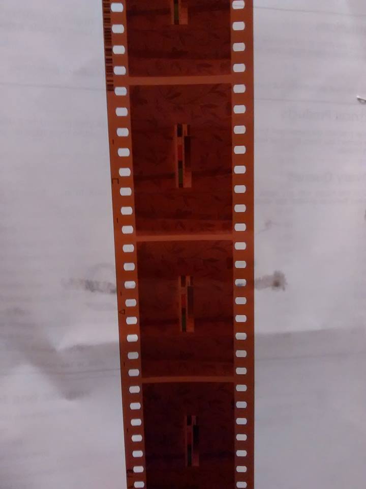

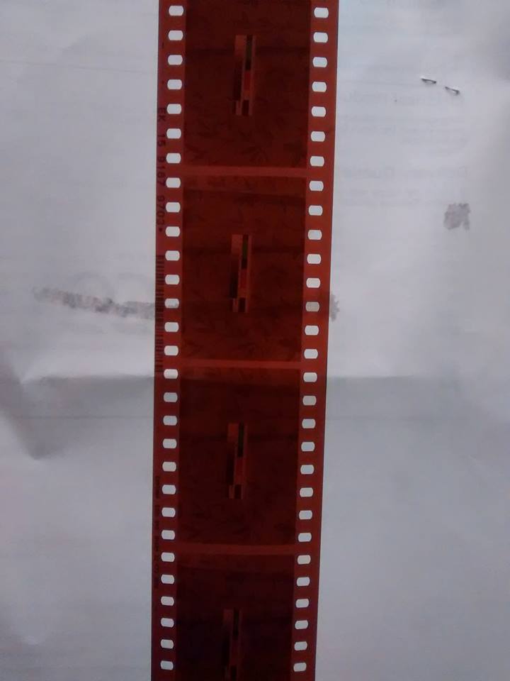

The Fuji reala I have could be at fault, it is old and is not 500 iso anymore, I shot a roll at the rated speed and the negs were thin. I shot another roll at 250 iso, the film I ran last night. The result was bulletproof negs, maybe 400 is a more realistic speed to shoot it at. But, both rolls showed the Blue Hue!. Today I shot a short strip of each Vision3 500T with 85 filter and UV at 320 iso, Vision2 250D at rated speed and Vision2 50D at rated speed. I taped them togther and ran then on one reel. There is NO Blue hue from what i can see, have to wait for the film to dry to truley see. But could the old age of the Reala cause it to be fogged?.
The top two pics are the Vision2's the 3rd pic is the Vision3. The Vision3 has a film base bordering on Brown!.
Last pic is a 5mp scan of the Reala I shot at 250 iso.

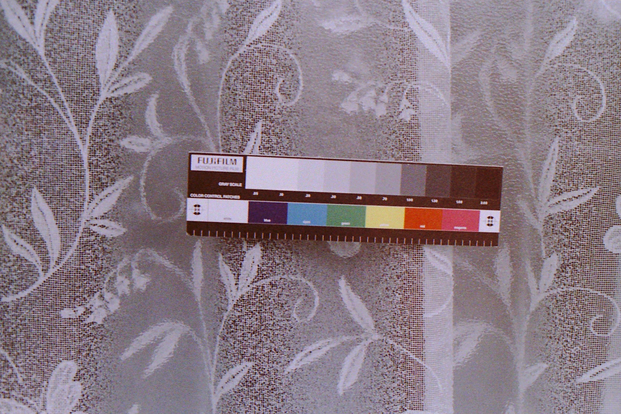

Here are the scans from the Kodak films Dev'd in homebrew ECN2 minus the AF200. All shot under full cloud within half an hour. Camera is Canon T70 with 35mm F2.8 lens set to auto.
622_04 Vision3 500T with 85 filter.
214_04 Vision2 250D.
858_04 Vision2 50D.
The 500T has the closest colours!

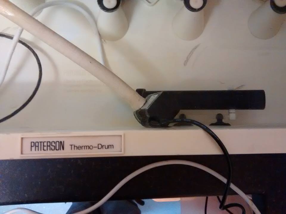

I bought a Paterson thermal tank to try and iron out the variables, its working but the heater creates a hot spot due to no circulation so I have a small 12v submersible 200lt/h water pump coming from Amazon. Consistency with colour work seems to be part or all of the key.

I'm honestly trying really hard to get better results, I installed a mini pump in the Thermo Tank, that has helped a great deal. But after tonights experiments I think it is the film as much as me that is at fault.

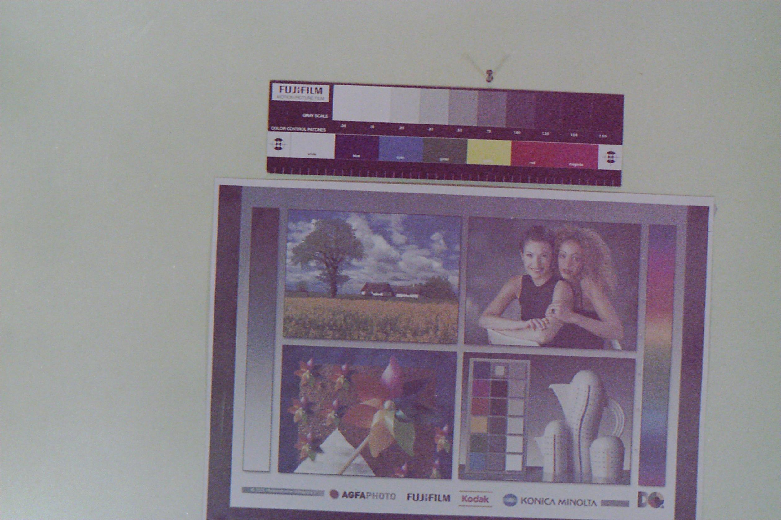

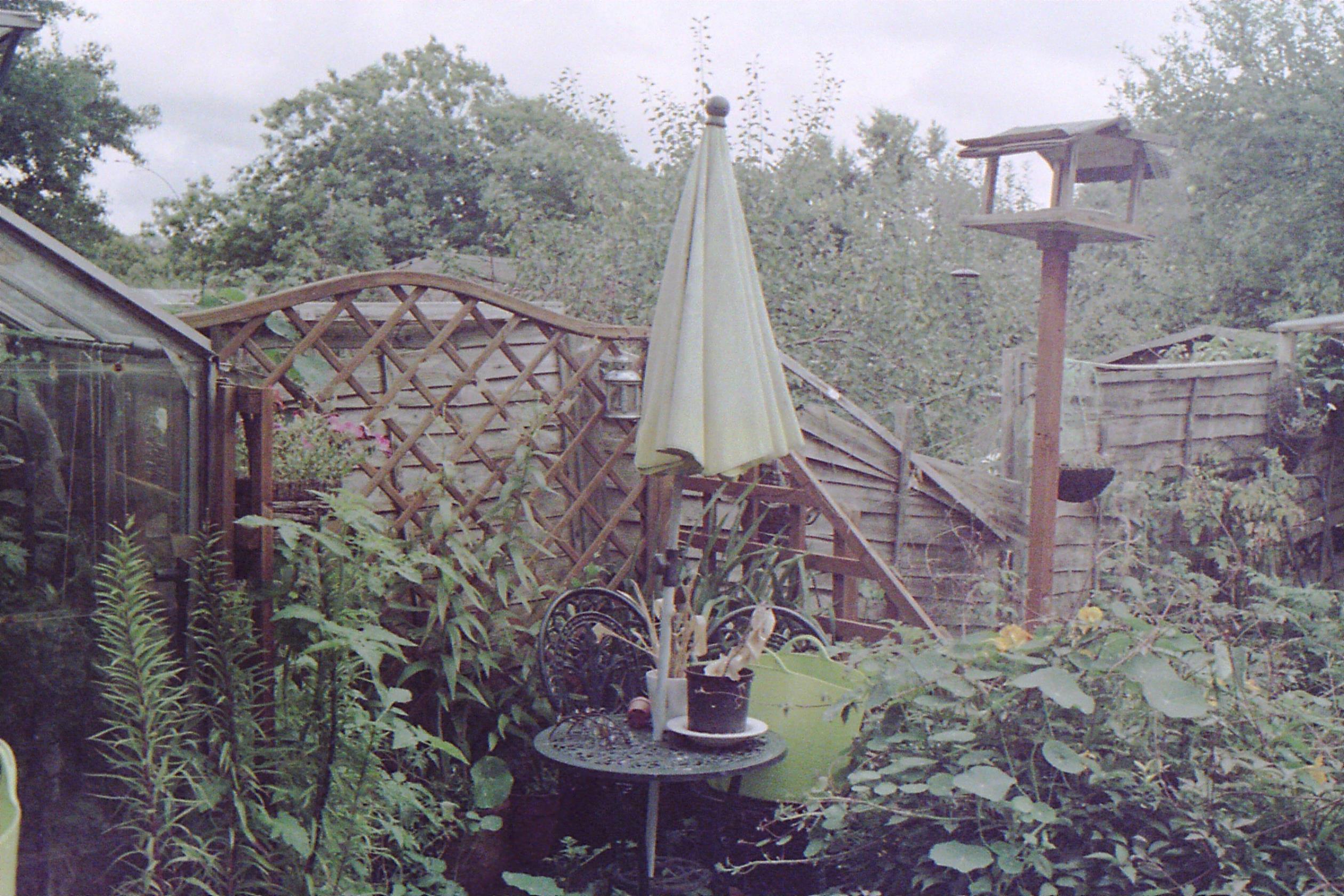

Colour card pic is the Vision2 500T date on film edge is 2006.

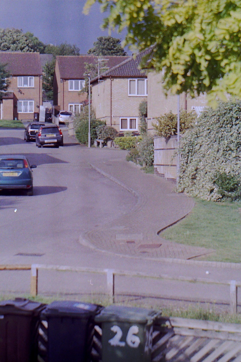

Street pic is the 65mm V3 500T that I slit down to 60mm and shot with an Ensign Ranger II. Film is date coded LS 2016.
I used the same batch of homebrew ecn on all the films posted on this thread, also the same ÂŁ10 scanner. I had to stuff the Vision3 throgh the scanner with no tray, its just about fits through the slot.

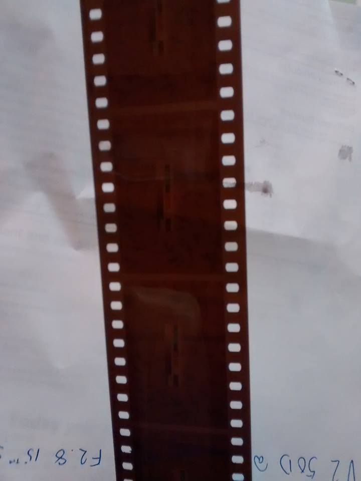

I processed another short strip of the V2 500T tonight.
Another thought as to why the scans are light and bloomed in places when scanned is that the carbon soot is getting on the emulsion!. Could it also add to the the bad grain look?. I have tried the re bath step that is mentioned in the ECN Module 7. I found that it causes some of the emulsion to fall away. It Is small tank developing after all.
Another problem that has arisen out of using the stop bath is that there are stains on some parts of the film, Maybe its mixed too strong/no t enough agitation or no good as the concentrate is 2 yrs old now and has growth in it. I have 60% sulphuric acid!. Any idea of the dilution rate to make 1lt of stop? also do I have to add any other chemicals?.
I've yet to put the latest purchased V2 500T through the Dev my lab mate gave me. I'll do that and see if there is any difference. Or did I do that already :/ . I really need to keep more notes.
When I put the negs in the enlarger to look at them with the focus finder all i can see is dust and any clumps of backing, no way i can see the billions of microns of the stuff that I am sure is there.
